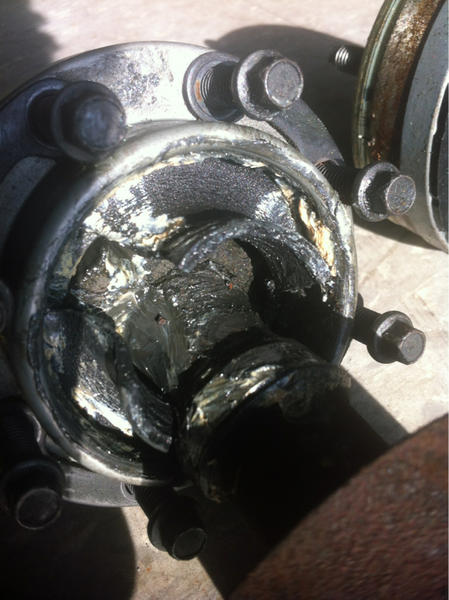

I went through 2 stock drive shafts with a 3" lift before I replaced with an after market and ripped the regular boot and the CV boot on both. I did drive around both times for several months before replacing and just kept watching the CV boot and packing it with grease as best as I could until I could replace it. Have an Adams DS now and I have not had a problem since.
