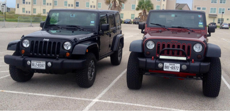

How good is this intake vs others on 07-11 jks? I'm a college student that lives in Corpus so it's a 70% road 40% beach jeep every week. Power and MPG is what I'm looking at for this product, not the sound it makes or doesn't make.
This is my rig as of right now
-2.5 RC lift
-35 BFG ATs
-dual cooling fan
-dyno cat back
Going to a 4.5" lift in mid nov. and power and MPG will be lost which I would like to get somewhat back. ( I plan to get RIPP headers too down the road )
