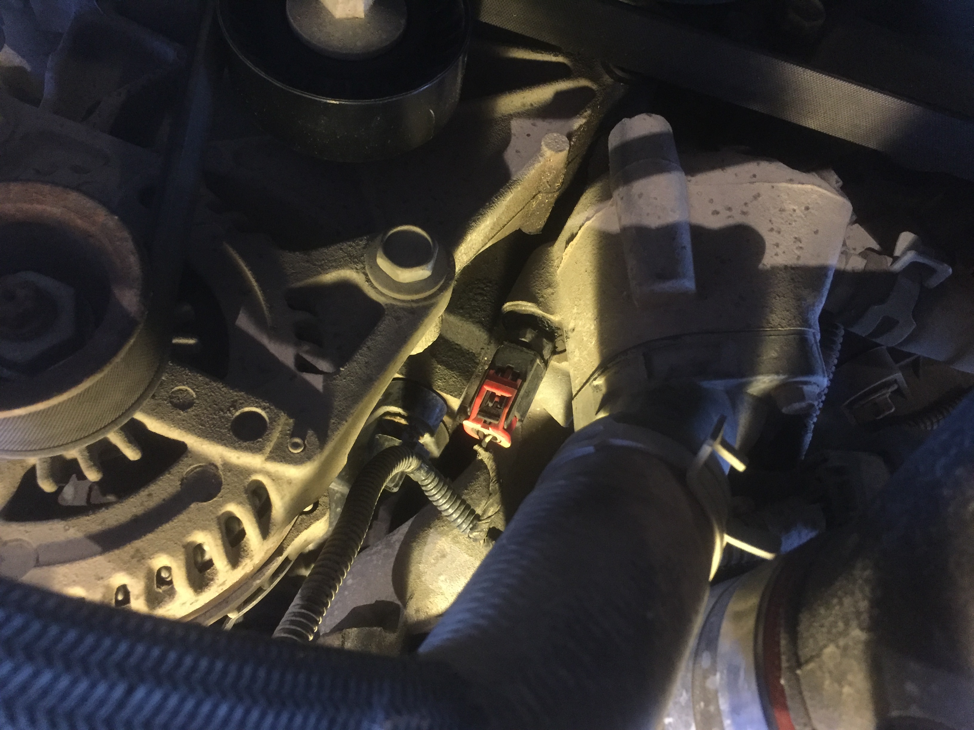

I have been having oil burning or leaking problems on my jeep for a few months now. Not really sure what is causing it but I have recently discovered a leakage on top of the engine. Not exactly sure what the part. It appears to be loose and is apparent that oil is coming from it, but I'm having trouble finding something to tighten it with. I am afraid to mess with it because I'm not exactly sure what it is if anyone could help me out here that would be great. I guess all I'm trying to ask is if anyone has encountered this before and how did you fix it. I can't get a normal wrench on it. BTW, I did change my PCV valve about 2 months ago and that didn't seem to do much with the oil disappearing, so this is the only thing I can go off now

(the thingy with the red on top)

The part you are referring to is your coolant temperature sensor. If loose or damaged, this part would leak coolant, not oil.
Okay thank you!
