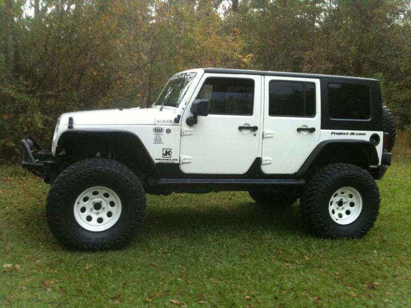

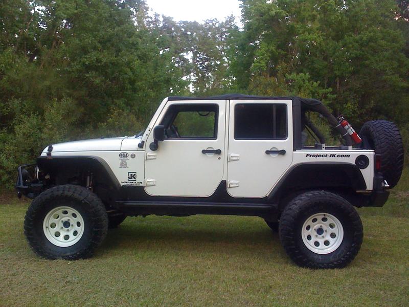

I have those tires, I have a TF 4in with one inch spacers and a 1in BL. with flat fenders and still had to do some trimming on the rear fenderwell. You really need about 6in on lift to run 40's. Tera flex kits are on the high side of actual lift.
on 37's.....

on 40's....
on 37's.....
Attachment 390850
on 40's....
Attachment 390851
It's...it's...soooo big! Nice rig dog! can you post some pics on
Big Rigs parked next to Stock Rigs thread?
I think I posted one on jeeps beside jeeps yj and lj on bb, haven't got a pic next to a stocker yet with the 40's. Haven't had them very long.
