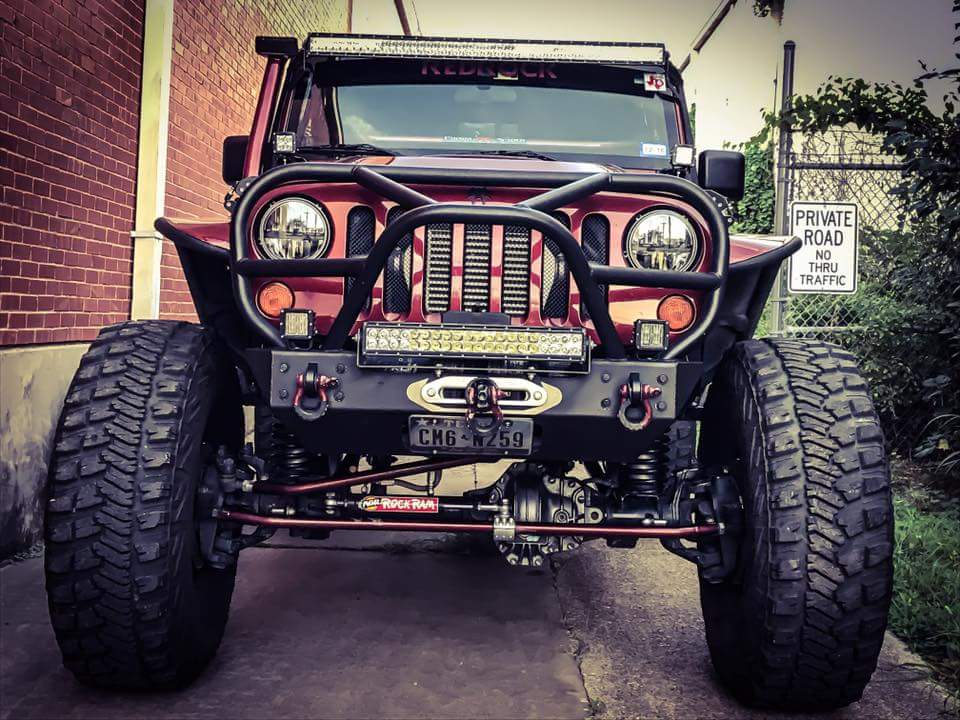

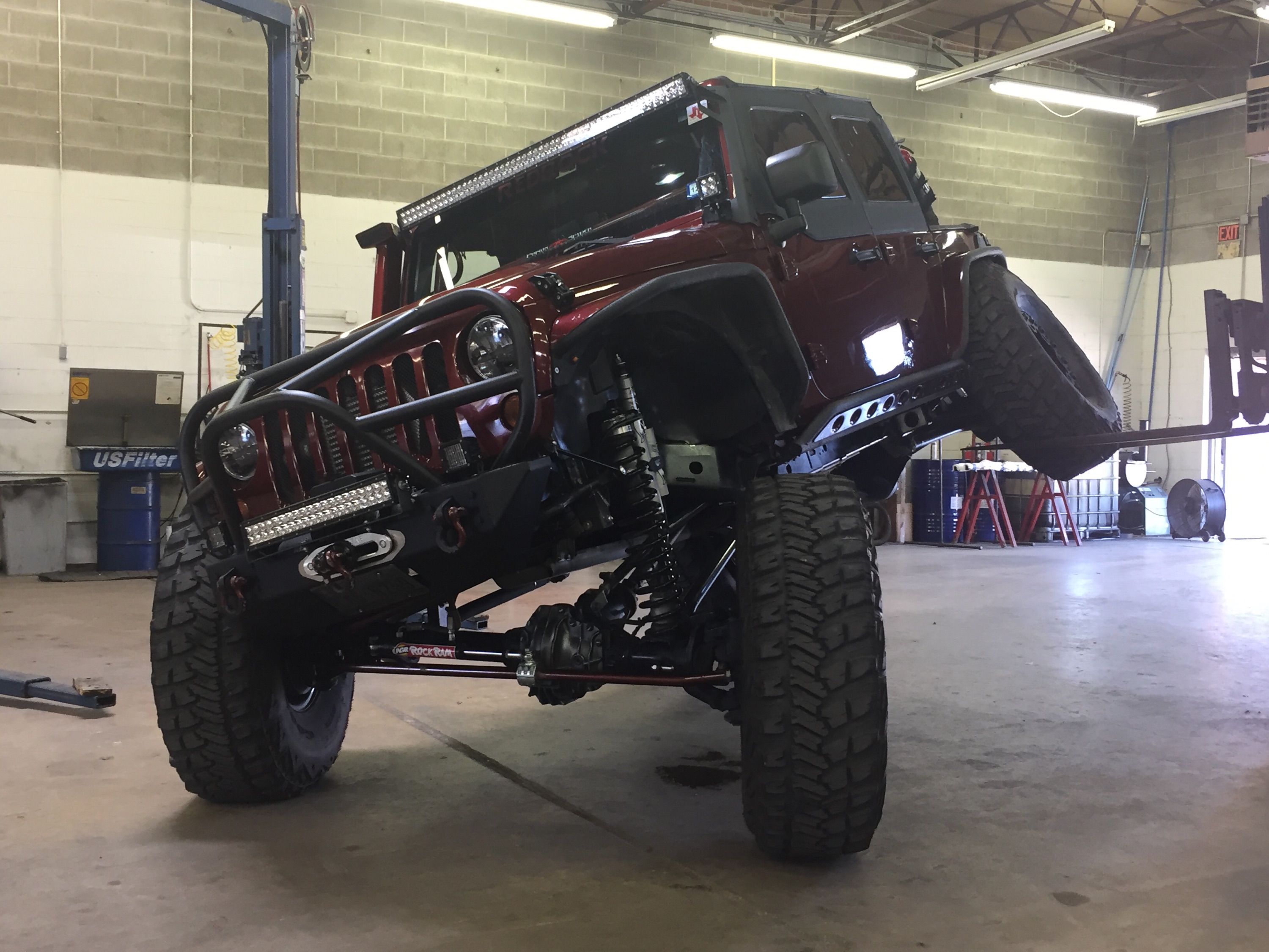

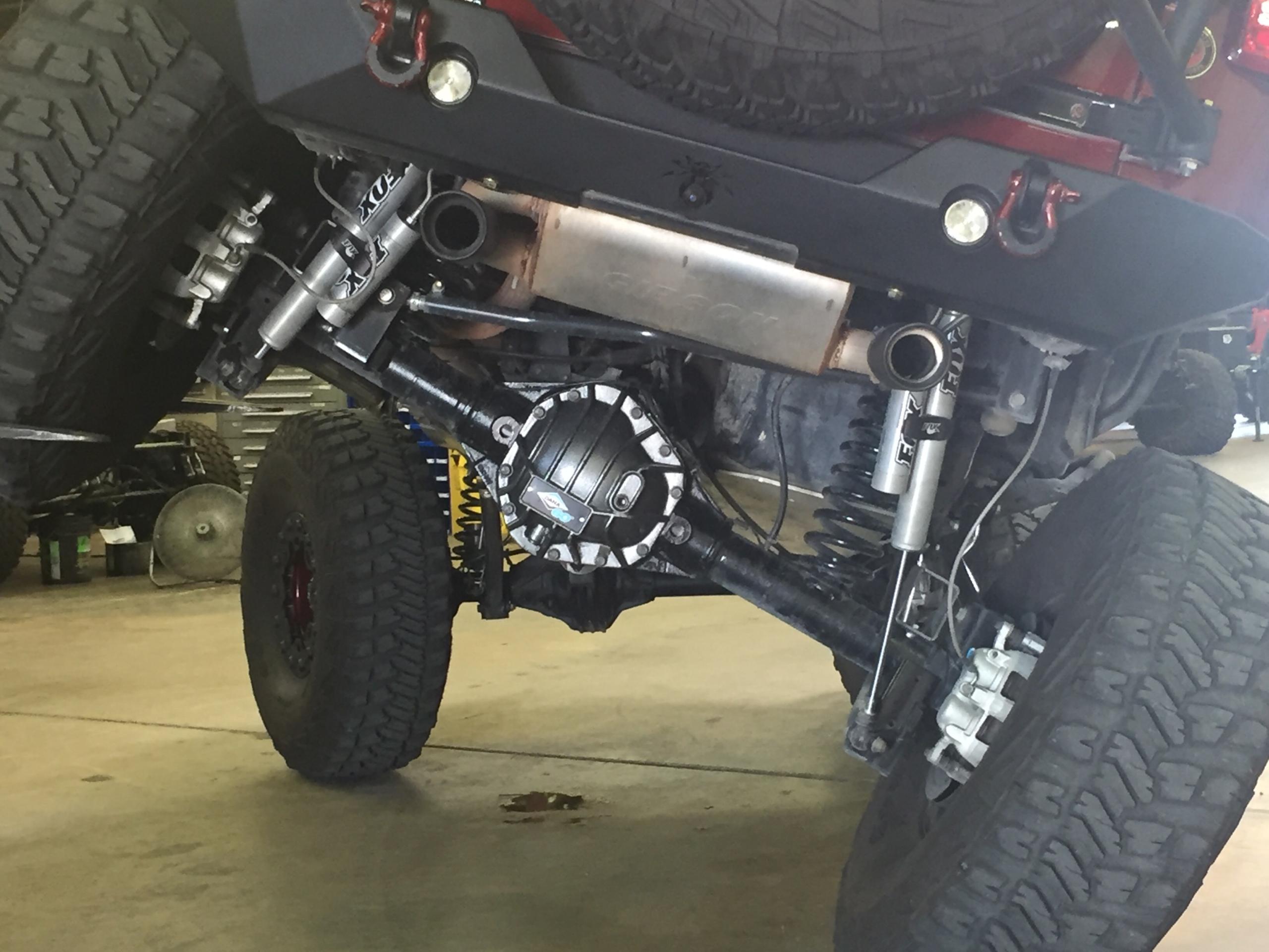

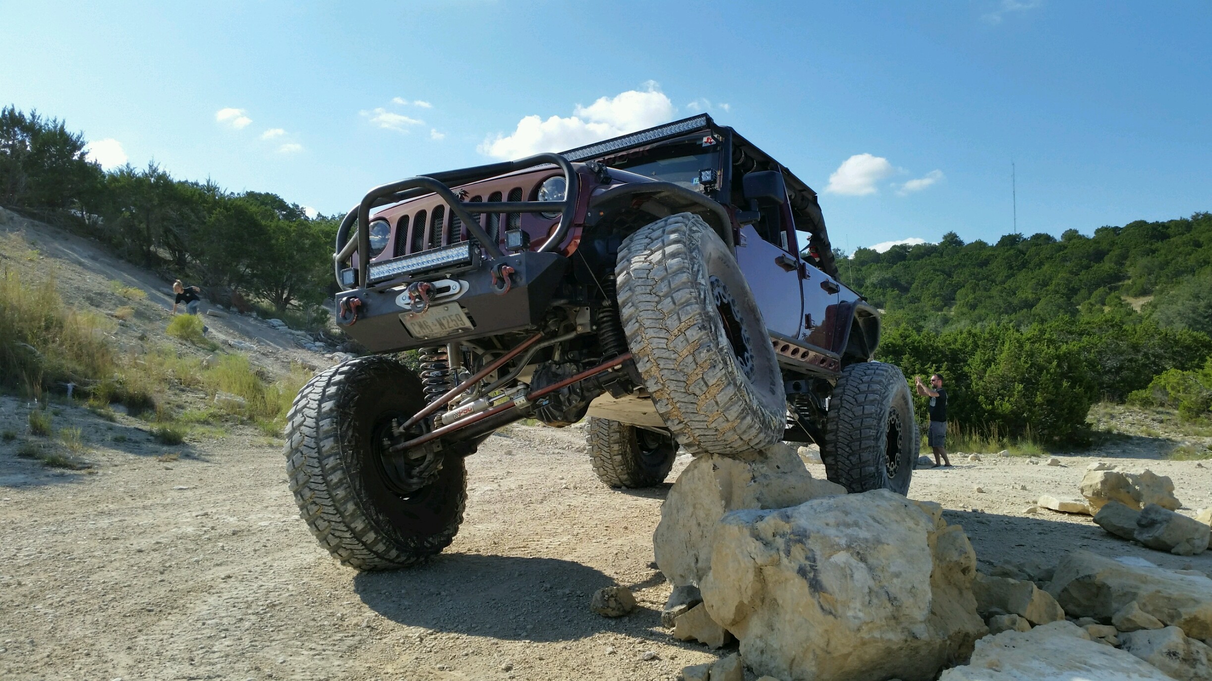

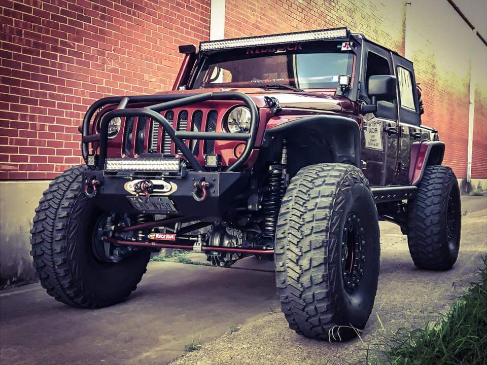

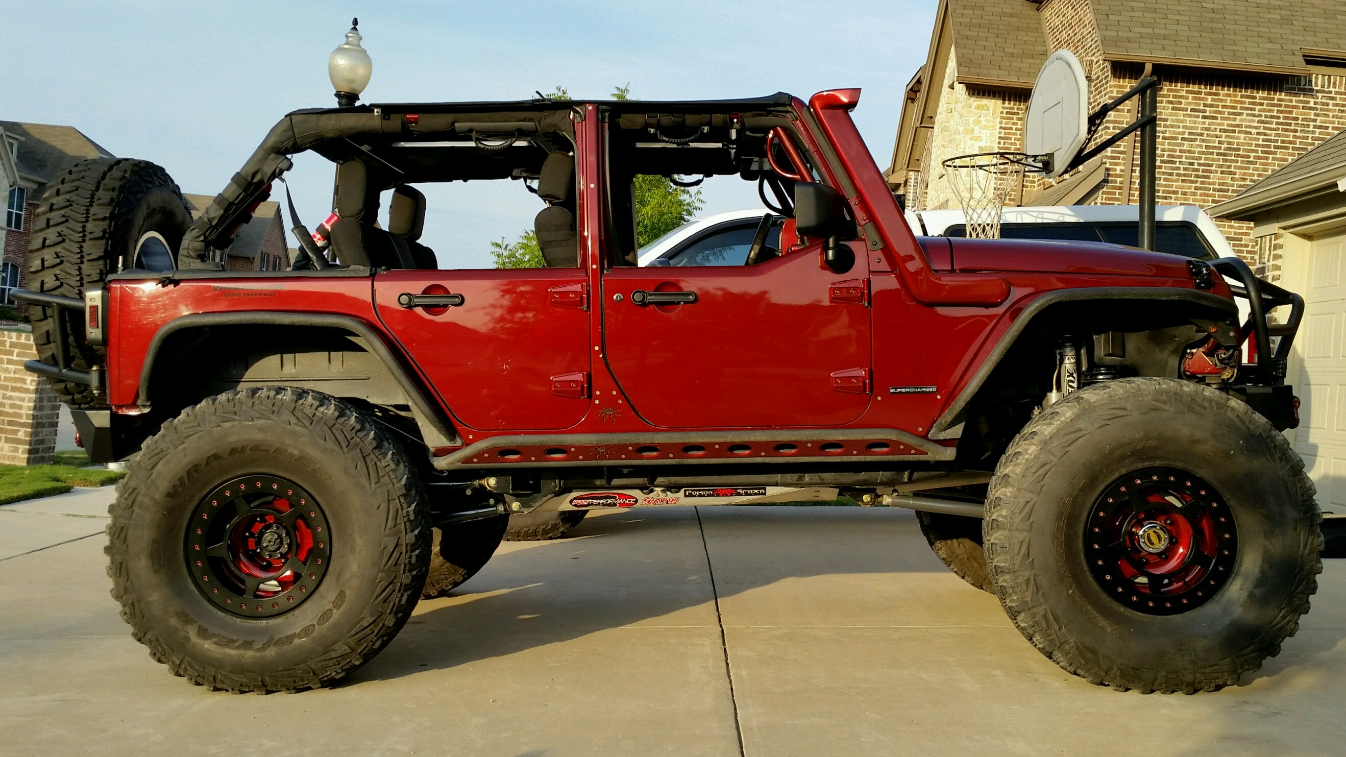

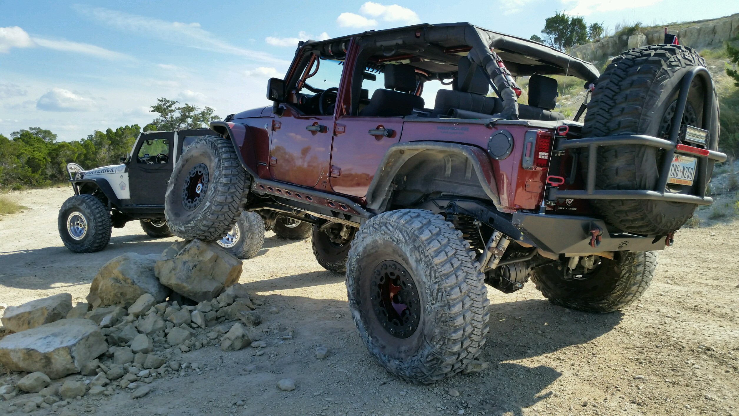

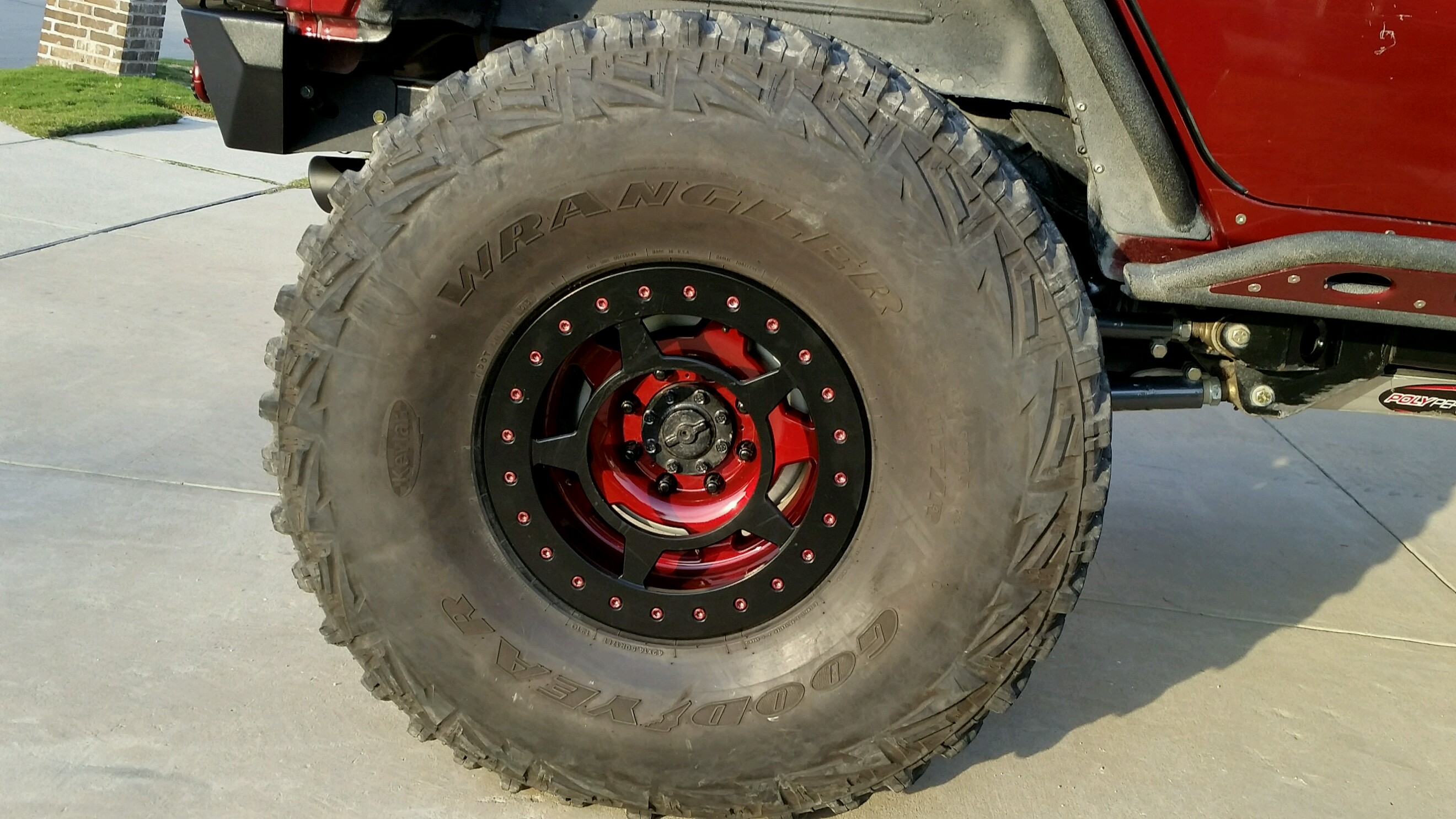

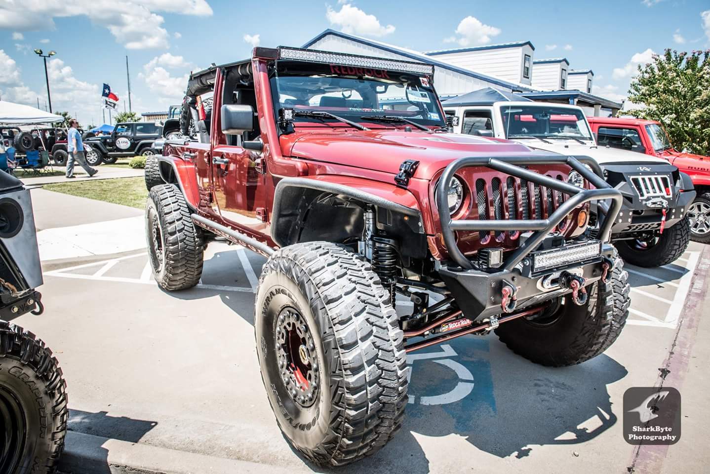

Finally got the 42s on and trimmed out, and did some wheeling with them and was impressed of how they wheeled compared to when I was on 35s, 37s, and 40s. Had to do alot of trimming, but they tuck and clear just fine without having to french the frame. The RIPP helps alot with the 42s, and moves them down the road at 70-80 mph no problem. Anyway I just wanted to share the progress I've been doing for the last 6 years and a few pics and show that a JK on 42s is very capable. Named her RedRock due to the color being RedRock Crystal, I know lame right...haha Thanks
Here is the build list:
3.8 RIPP Supercharger
Ultimate Dana 60 axles front and rear with 5.38 gears and electric lockers
6in Synergy Long Arm kit w/Fox shocks
42x14.50x17 Goodyear MTR's, 17x9 Spiderlock wheels
PSC Hydro Assist
AGR Hydro Assit Pump and Steering Box
PSC Reservoir
Poison Spyder (PS) Crusher Fenders
PS- Rocker Knockers
PS- Rear bumper
PS- B Pillar Armor
PS- Rocker Armor
PS- Corners with frenched in tail lights (At paint shop right now, will post pics when installed)
Gen Right Front bumper customized
Gen Right Rear tire carrier
Artec Belly Pan
PSC Hydro Assist ram
PSC Steering cooler
Synergy Tie Rod and Drag Link
Rigid 50,20,10in, and Dulley LED Lights on PS Mounts
Rockhard Cage
Trek Armor Seat covers
6 switch SPOD
ARB Compressor and Tank
Custom painted interior
Off Road Heros Cargo Top
40th Anniversary Hood
River Raider Snorkel
Much more, I just listed the major components

Sweet Jeep man. Can you provide more insight on how you mounted that 3rd brake light and light bar on your Genright?
Old Oct 20, 2016 | 01:57 PM
Jarhead0341's Avatar
Posts: 7
From: Texas
Thanks!, I just bought a led light from ebay, and drilled a 1in home in the middle and self taping screws to screw it into the bar. The 1in hold is because of the wiring and the round 1in plastic on the light itself. It was pretty easy.

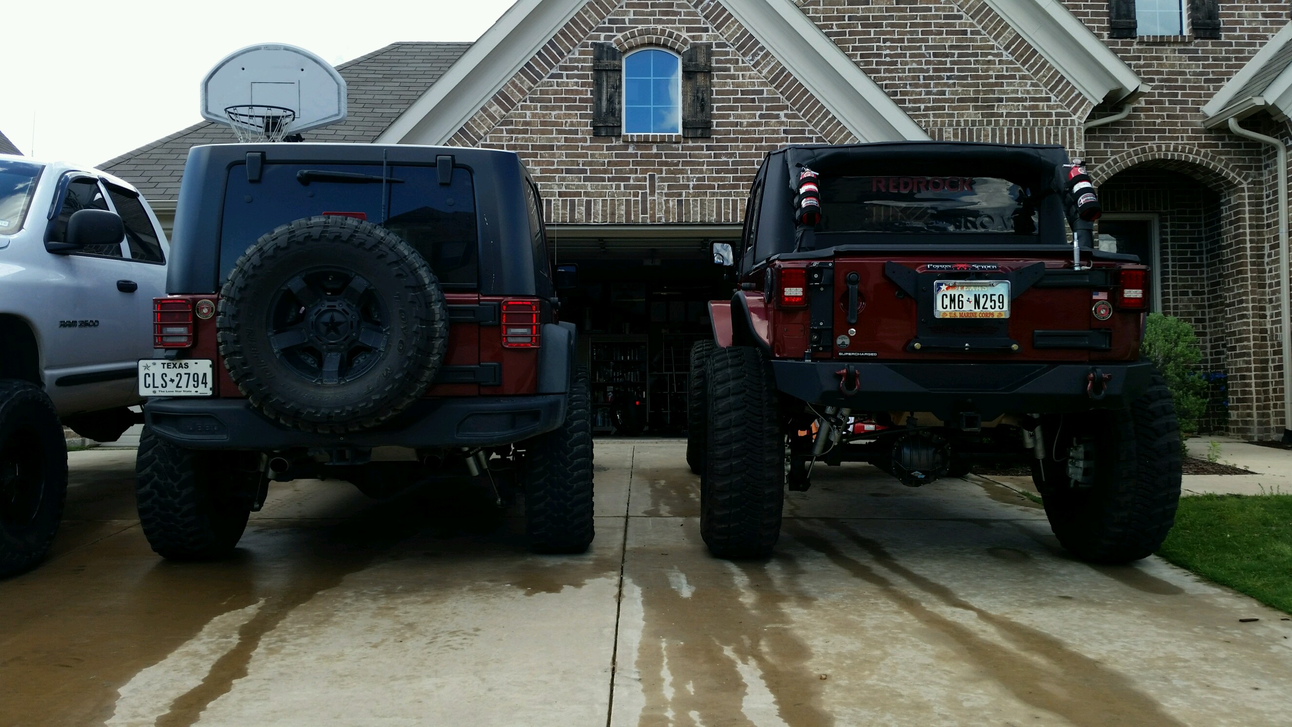

Thanks, its been fun forsure!
Thats my rig on 42s and my wifes on 35s, its a whole new world...lol

Originally Posted by Jarhead0341
<img src="https://www.jk-forum.com/forums/attachment.php?attachmentid=659437"/> Thanks, its been fun forsure! Thats my rig on 42s and my wifes on 35s, its a whole new world...lol
Which one of the two would you say are more streetable?
Old Oct 23, 2016 | 11:57 AM
Posts: 7
From: Texas
Believe it or not, I drive my jeep on 42s daily and to me it drives way better than my wifes JK on 35s. The Ripp Supercharger and hydro assist make it like driving a Cadillac. It has no problem driving 80 mph.
