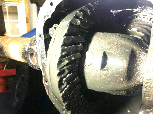

This is what it looked like

Ouch sorry that sucks. In the future try to avoid putting any load on your jeep while in reverse as you are riding on the weak side of the r & p

it just doesnt seem right given the G2 axle gears are top of the line.
I thought this was humorous, given the picture that followed. Aren't G2 gears coming out of the same plant in Asia as most of the others? Same manufacturing, just a different name on the box?
At least you'll know to be careful in reverse next time.
Any load? That's kind of unrealistic, isn't it? You're kind of forced to use reverse with a load in many off-road situations.
It's can't be that prone to destruction. Must be other things at play.

Originally Posted by arjeeper
Any load? That's kind of unrealistic, isn't it? You're kind of forced to use reverse with a load in many off-road situations. It's can't be that prone to destruction. Must be other things at play.
I just assumed going backwards over a snow bank meant she was trying to climb a snow bank with her tires spinning and chassis bouncing. You know......load. Not talking about backing up on a trail to correct a line which is the only time I use reverse offroad and really is the only time it should be used unless you like showing off
