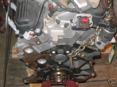

Old Dec 6, 2007 | 10:26 AM
russ_jk's Avatar
Joined: Dec 2007
Posts: 9
From: australia
Unhappy
this is a pic of the 3.8 bell pattern, definatley positivley completly different to the v8
Name:	jeep bell2.jpg
