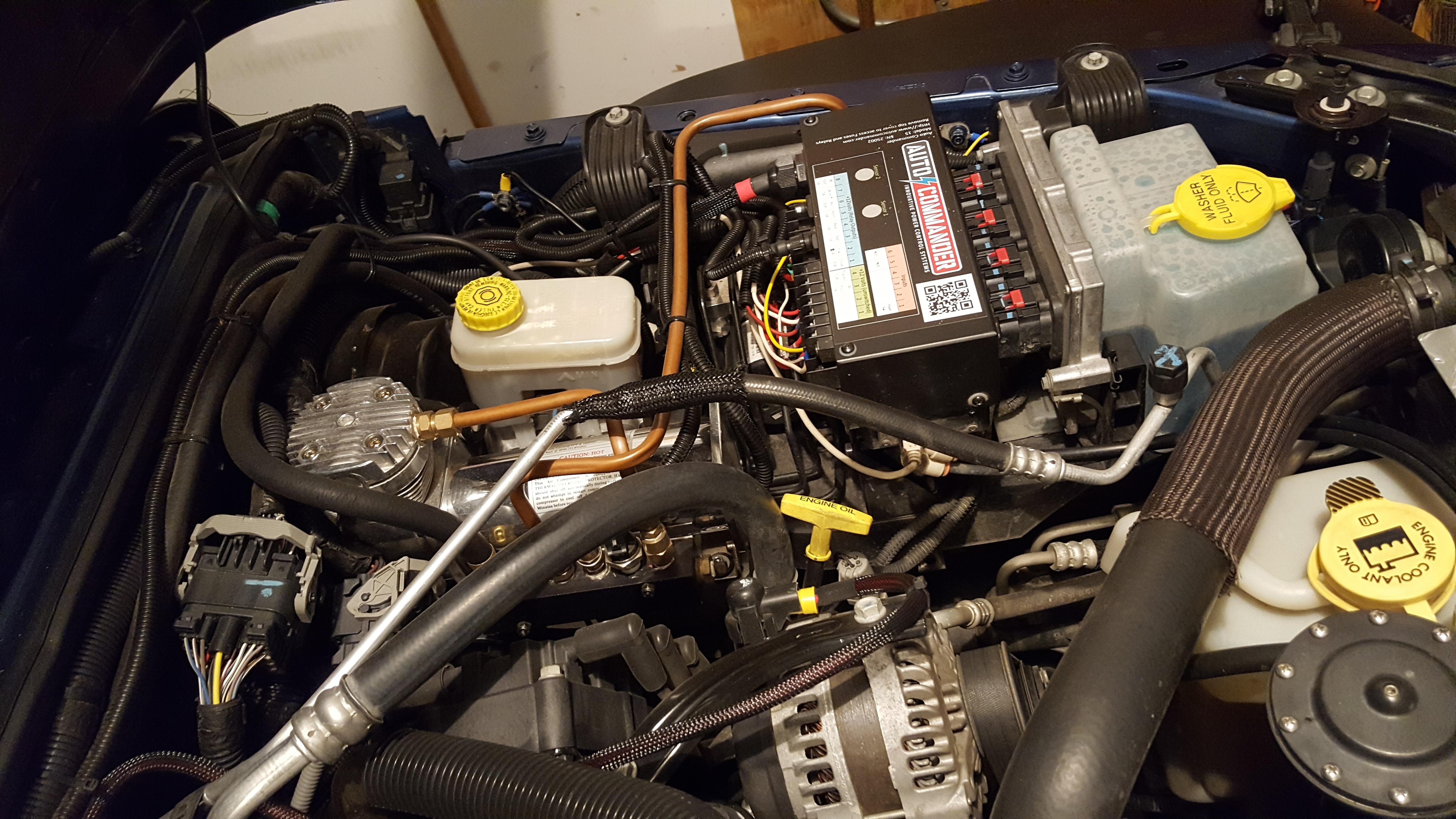

Here are some pics. My tank is not well protected. It has gotten a few dings. River Raider used to make a skid for it but I think it is discontinued. The compressor is mounted to the brake master cylinder and all the plumbing is dressed in. Currently I am only running 2 of the 4 train horn bells. I had to remove to to fit the cold air intake.

This setup from Kleinn looks like a good alternative that is protected. Getting the compressor out of the engine compartment is a very good thing because it gets too hot under there. However I am not sure about putting the horn bells down there under the vehicle will work well for long. I can just imagine standing along side of the Jeep when a horn full of mud is blasted out at my feet by 120 psi.
