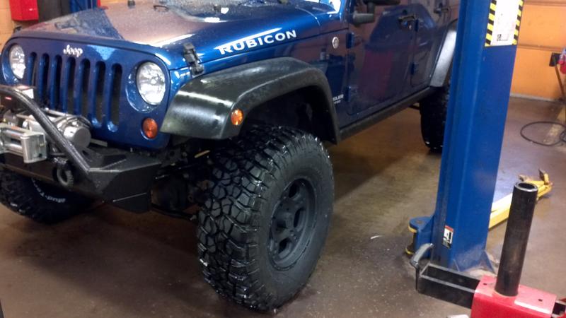

OK installed...
ID:	223903Click image for larger version
one before lift, one after...

Very nice. Which fog lights are those?

the pilot 203w i think, fallowed the write up on here, worked like a champ..and love em
