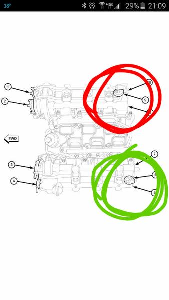

So I fixed my issue, I had do idea you had 2 (technically 4 but there are 2 in one "sensor") camshaft sensors. I will attach a picture so it makes more sense but I replaced the only one I could find which was "A" my code is for "B", and it's located, (see picture, red is what I originally replaced, green is what you need to replace, bank B). If you take your hand and start at your oil cap, follow the cam all the way back and around the corner to the left and down. You will find your second cam sensor. Once I replaced this I have had zero issues. You can't see it if you just look for it so you actually have to feel for it, took me longer then I'd like to admit lol. Hope this helps man!

So Sensor A is going to be the one I circled in red in that picture, (My problem was I replaced the wrong one) A is really easy to find, for me (2012) it's right under my tranny dip stick. Just follow your cam towards the rear and you should find it.
And yes, both lights came on within at least a few minutes when "it" would happen, & both lights went away after I replaced it, I did clear my codes with my programmer right after I fixed it though, you can just disconnect the negative wire off your battery term if you don't have one or access to one.
Also, I recommend buying this part from Mopar direct. I just went online, easy to find. But I'm not willing to take risks with anything other then Mopar for senors and shit. Just my $0.02.
If you have any other questions I'd be happy to try and help. Just a girl trying to figure shit out.. lol
