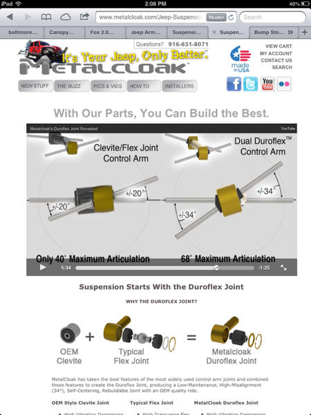

Originally Posted by olram30
Control arms don't give flex.
Well it seems that metal cloak thinks you are wrong sir. MC claims to give you 28 degrees more flex. See the pic.

Guys, aftermarket arms will absolutely Allow more flex by having less bind. But just because an arm can offer 15 degrees higher misalignment, doesn't mean your jeep is set up to take advantage of it all.
This is true, shock length and spring drop have to match. But at full flex the MC's are not binding metal to metal.
