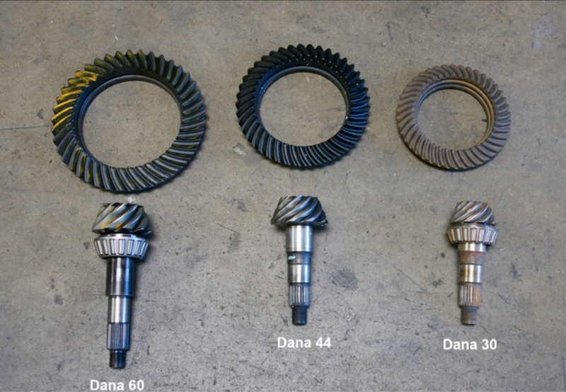

Makes a big difference in the r&p when your talking 5.13 and 5.38 gears due to the size of the teeth
