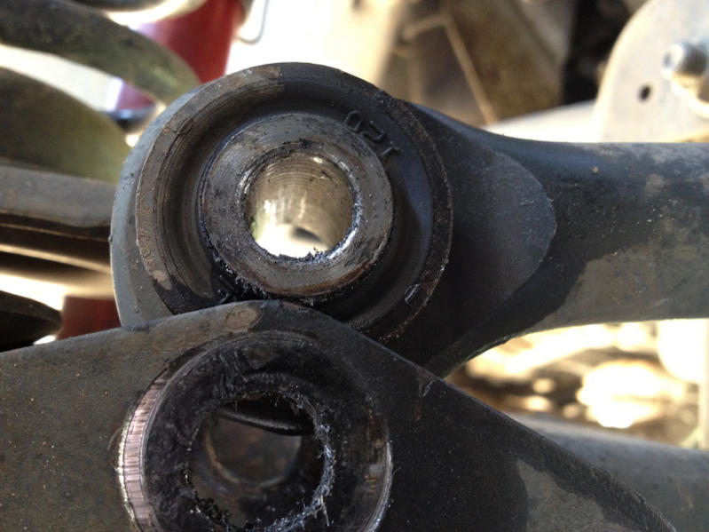

I found I only needed to change my Track bar bolts, as they had wallowed out over time and was causing my DW.
Here is a couple pics of my TB bushings right before I installed the grade 8 9/16" bolts.

I just bought a new TB after using the grade 8 bolts for the last 12k miles, and they fixed the problem. But my bushings finally died.
All my control arm bushings still looked good, so I didn't spend the money to upgrade those. Just my front and rear TBs.
