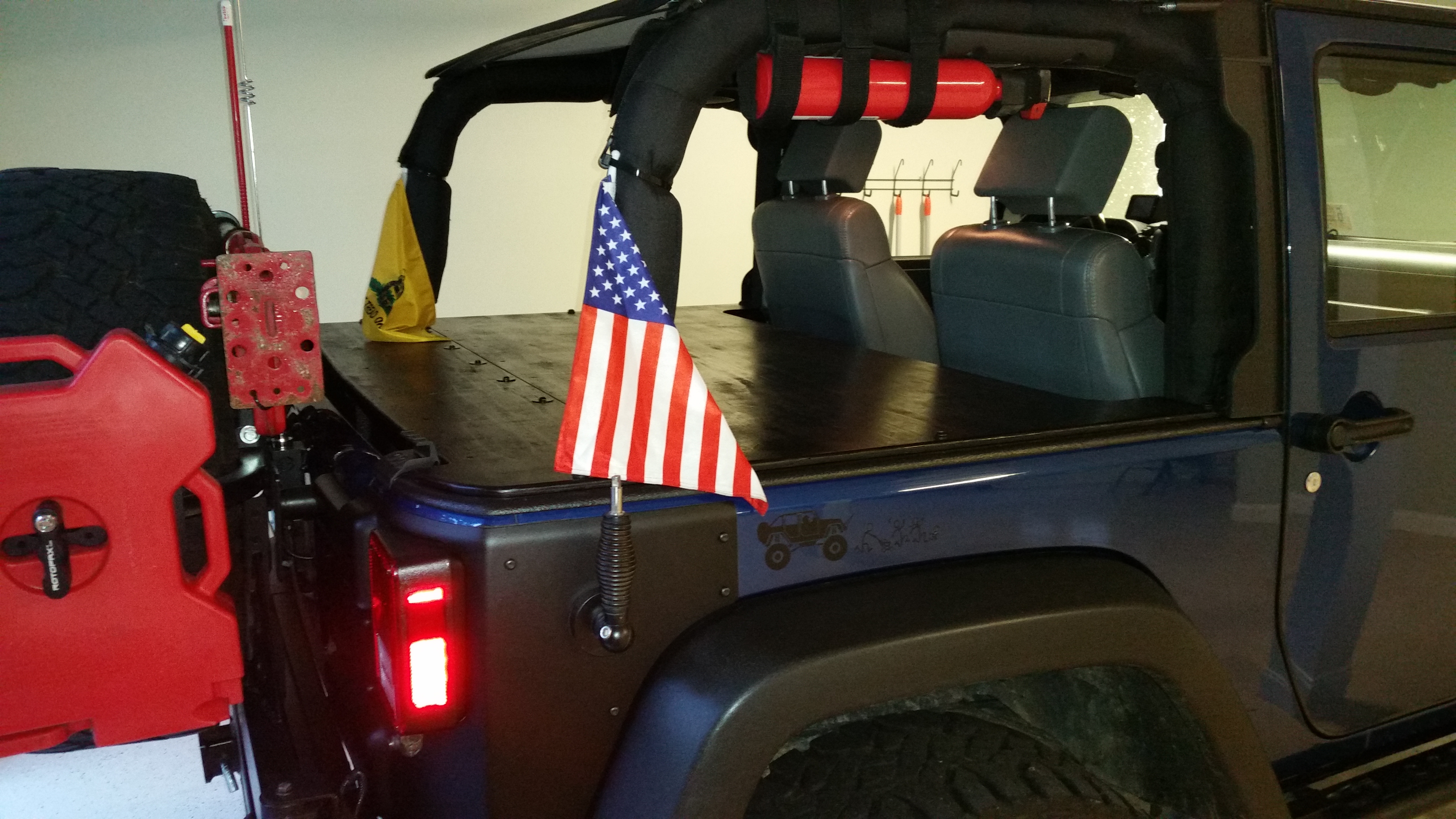

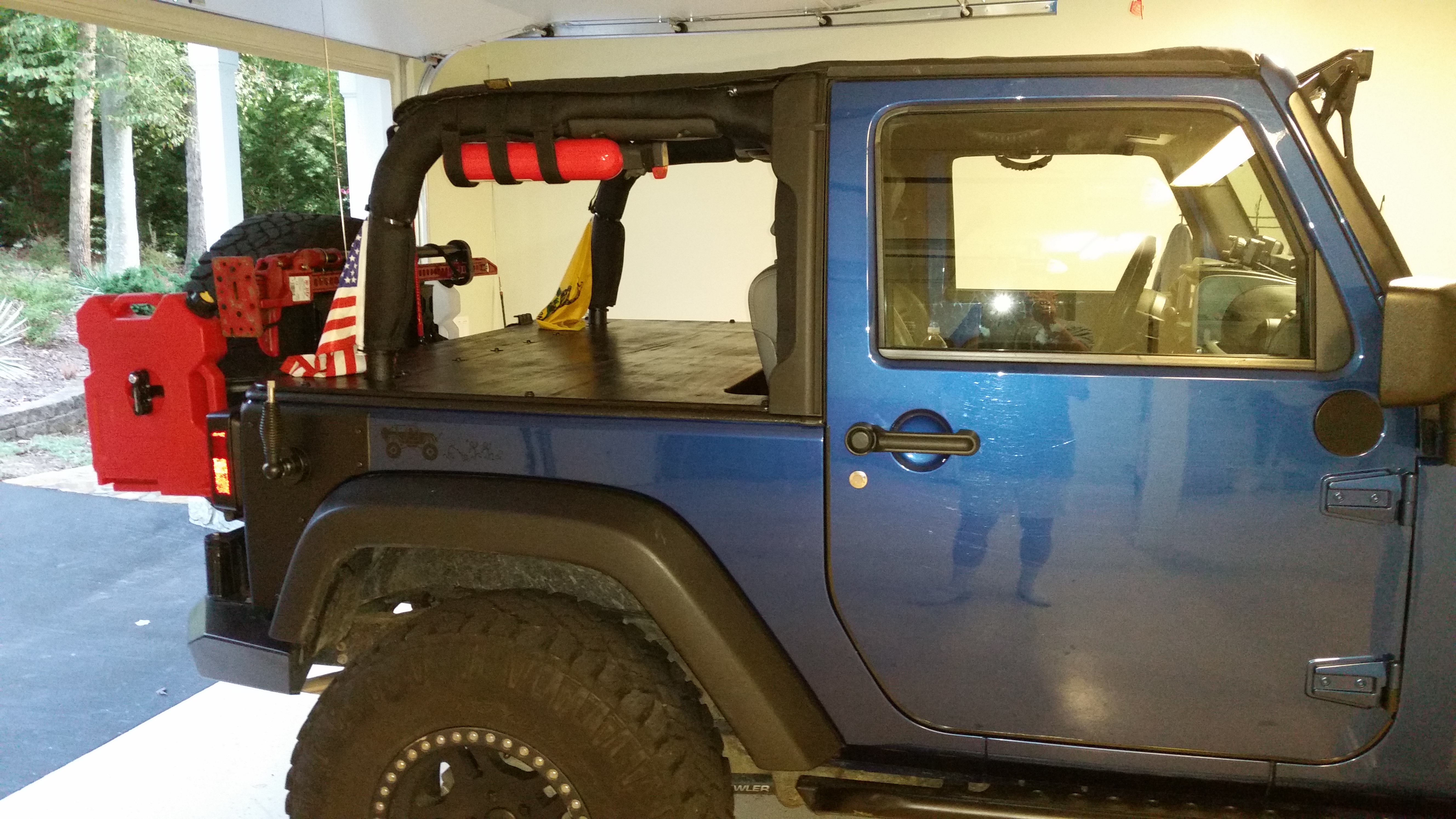

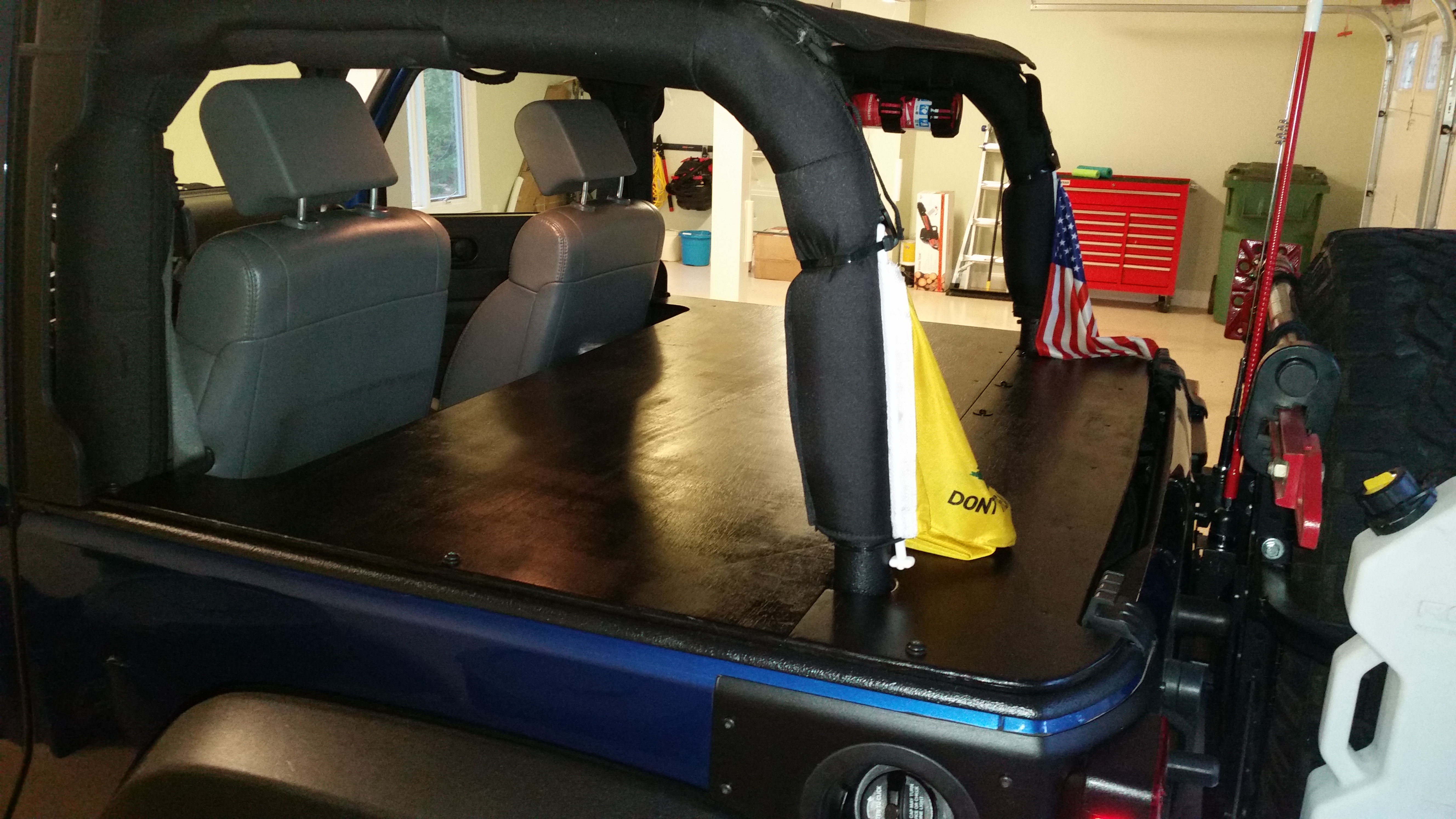

I saw where someone had fabricated a cover that goes over the entire rear area where the back seat was. I liked the idea and fabricated one of my own. It is very simple and sturdy. I always have a lot of gear and tools in the back and with the cover they are secure. I really liked the Backbone cover at backbone.com but at $650 the cost is just too high.
Mine took just 1 evening to fabricate and another day for the finish to dry. It still needs some finish work so it is more uniform, but I didn't have the patience. It is 1/2 inch finish plywood with 3 reinforcing 2x4's underneath that go from side to side. It is sturdy as all get out.
Right now I put all my gear in plastic bins, but soon I am going to fabricate a large drawer that pulls out. Also I am going to add some tie-down rails on the top for a cooler/tent/... http://www.uscargocontrol.com/Ratche...Tie-Down-Rails
