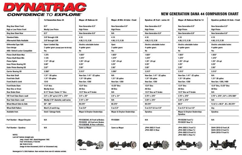

Originally Posted by KG6SLC
The D44 Rubicon Front axle has 8.5" ring gear, 30 splines on the axles and has an axle diameter of 1.31"
The D44 Rubicon Rear axle has 8.8" ring gear, 32 splines on the axles and has an axle diameter of 1.41"
Ring gear on the rear is the same, Rubi or not. It is 8.5" diameter. Axle shafts are stronger though. So yeah, overall, Rubi D44 is stronger than non Rubi.

Originally Posted by ExpedJK
@ Ring gear on the rear is the same, Rubi or not. It is 8.5" diameter. Axle shafts are stronger though. So yeah, overall, Rubi D44 is stronger than non Rubi.
Like I said.....There is a lot of confusion. This chart clearly shows the New Generation (JK) rear ring gear to be 8.8"
Attachment 397669
Don't know how the wrong quote got in the last post. Even my edit shows the quote from the terminator.
Old Dec 12, 2012 | 04:16 PM
TheTerminator's Avatar
Posts: 791
From: Vancouver, BC
Well, that's strange that Dynatrac shows it as 8.8". Yukon Gear has it as 8.5":
Differentials: Dana 44 Rear, JK Rubicon - Dana 44 Rear, JK Rubicon
If you check their R&P sets for Rubi and non Rubi JK, they have exact same part numbers too.
