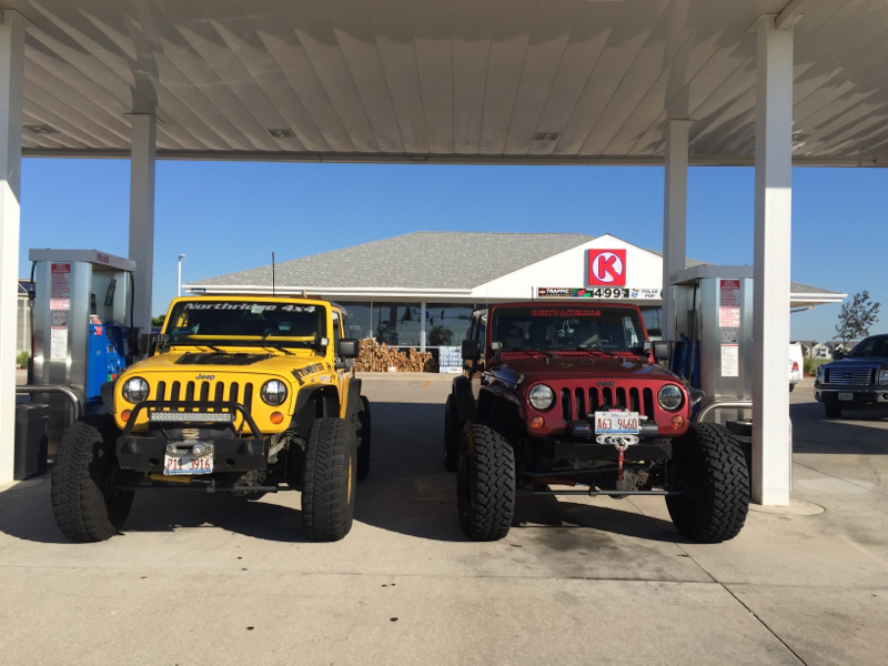

Driving with a group to Colorado from Chicago. My budy:
with a 3.8 JKU 6speed 37" Nitto TG on method beadlocks and 4:10 gears loaded up with wife and 3 teenagers and gear for a week.
Me:

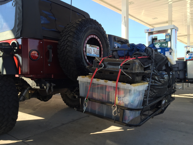

3.8 auto jk 5:13 gears 37 MTR on method beadlocks 2 young boys and wife, pulling a 500lb trailer with our gear.so maybe 800-100 total. Trailer has 33" Nitto duragrappelr
Ambient temp is 95-100+
I'm struggling through through Iowa. Sooo bad my ending water temp is getting to 250. Unless I slow to under 70. Any hill requires me to turn off OD. Trans is running 160-180. And I have a BM aux cooler in front of the radiator.
He is having no trouble at all!!!
WTF???
Am I doing something wrong? I've had the coolant flushed, oil is fresh. Running hood louver and cc inner vented fenders.
Is is just the different trans and hearing that's causing this??
Suggestions??
