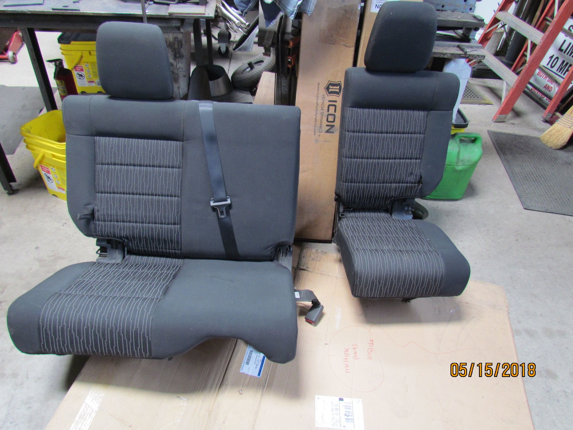

Hey guys
I have a 2010 jk wrangler 4door without rear seats and recently I've been searching for replacements but only been able to find rear seats of Jk's 2011+.
I just found a full set (front and rear) of seats out of a 2018 JK for $400 and was wondering if anyone here knows if I could install these on my 2010 jk without issues.
Really appreciate the help!

I think the rear seats should be a direct bolt in. It seems I recall you can do the front seats but they need a minor modification. Maybe it was the airbag sensors that was different . Just seems like there was something keeping it from a direct bolt in swap.

I have a set I
took out of my 2011 day I bought it.
Picture is the most resent I have but stored inside on my racks.

I have a 2008 jku and replaced my seats with 2014 seats. I only reused the old seatbelt receivers on the old seats because the electrical connectors were not the same.
