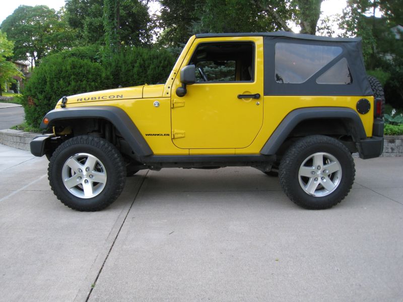

Hey are you running that lift/spacer combo on stock wheels and tires? If so, do you have any pics of it? I'm running the Spidertrax spacers on mine, but its at stock height. Just wondering what it looks like since we have the same ride...
Mudflap - It makes all the difference in the world. Do it as soon as you can.
Thanks for the pics! Yeah it does make the Jeep look more... Jeepy. I'll think about it...
