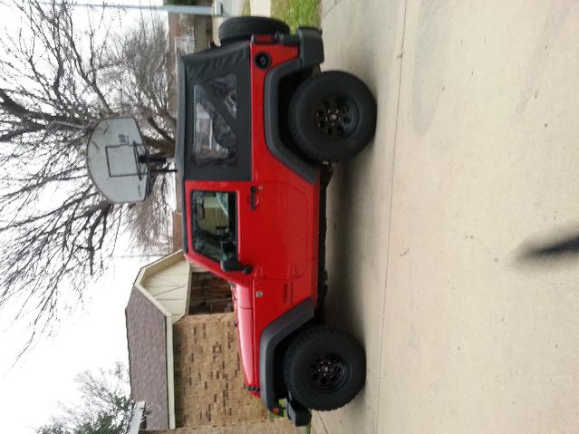

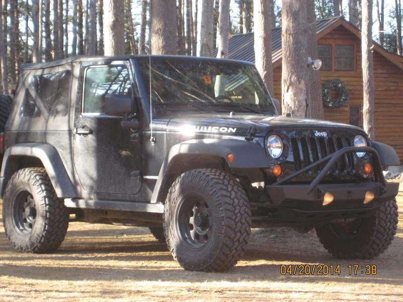

Do have to go that much wider? I put 33x10.5r15 on my 13 jk. Downsides to this is your selection of both wheel and tire is minimal. Pretty much only get bfg at KO or km2 (I think) Its my DD and don't wheel nasty enough or offer enough so I got AT.
You'll need at least level kit or trimmed fenders. Won't have any steering issues BC most 15's that fit without grinding are 3.75 backspace. DTD is a great resource for this.
FWIW I went from 225\75 r16 with auto, 3.73 and AVG MPG is identical after 2k miles. City went down a tad and hwy up to offset. I DID notice a difference in butt dyno but still feels really good. Better than the wife's '14 civic.

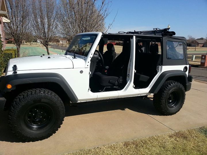

I had 33s on my JKU while waiting on all my suspension components to come in:
Limits flex, but mild offroading is still possible.
If you go 15s, just know that you may need some caliper grinding in order to fit them. Typically, all the 1-piece aluminum wheels should fit just fine. It's the 2-piece steelies that are hit or miss. This is due to their design. The 1-piece aluminum wheels are call cast from the same mold, but the 2-piece steelies are just that, two separate pieces formed together into one wheel. The very nature of their design means that tolerances aren't as tight as they are a 1-piece cast aluminum wheel. So, even across the same exact size and model wheel, 4 of them may fit while your spare won't.

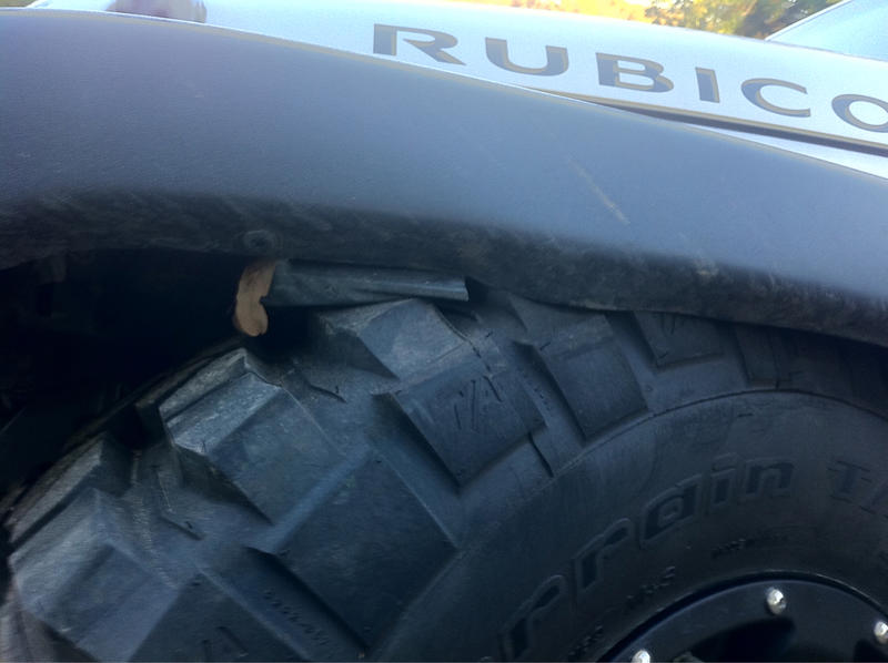

33s will rub with stock flares without adding increased bumpstops when disconnected. You'll also rub on the rear flares too.
That is a 305/65R17. Same as a 305/70R16
