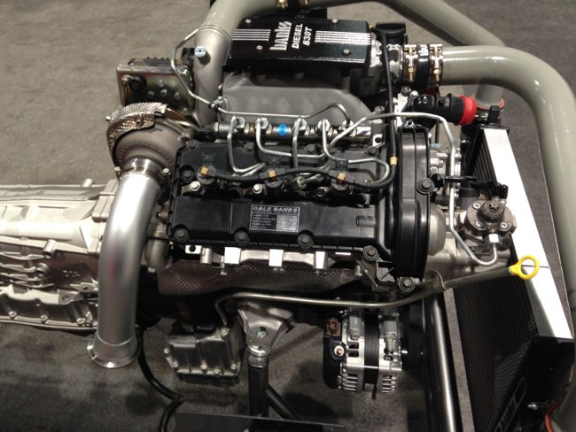

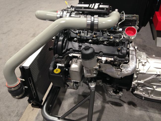

I have ridden in a 6.4L Hemi conversion, and it is 1000% better than any V6+supercharger/turbo. If you have the money, go with the 6.4L swap! In the end, I will most likely keep the 3.6L with the RIPP Supercharger until I find a CARB legal diesel conversion. Hopefully, someone will eventually offer a swap to a VM Motori 3.0L V6. With a couple of modifications it will make 450 ft-lbs of TRQ and get 30 mpg!
