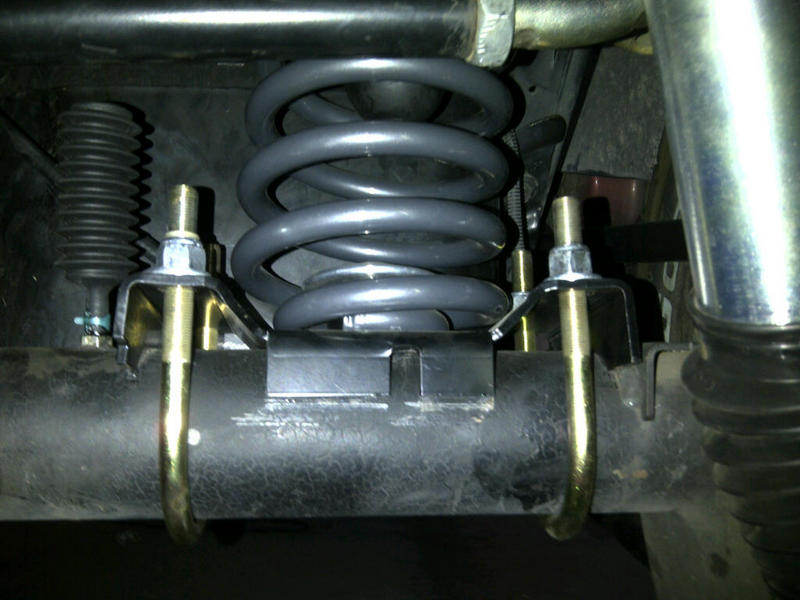

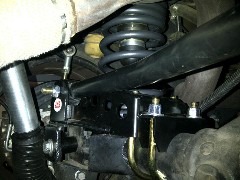

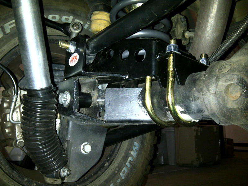

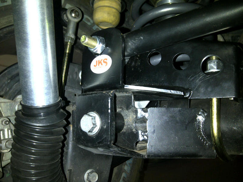

Longest part of the install was cutting off old perches, grinding axle smooth (dremmel), and painting axle. Took a few adjustments to get them aligned just right. Use an angle finder to get them both at the same angle.
Here are some pics including the new JKS track bar bracket which raises the axle mount up 4" and works perfect with the perches and track bar brace.
