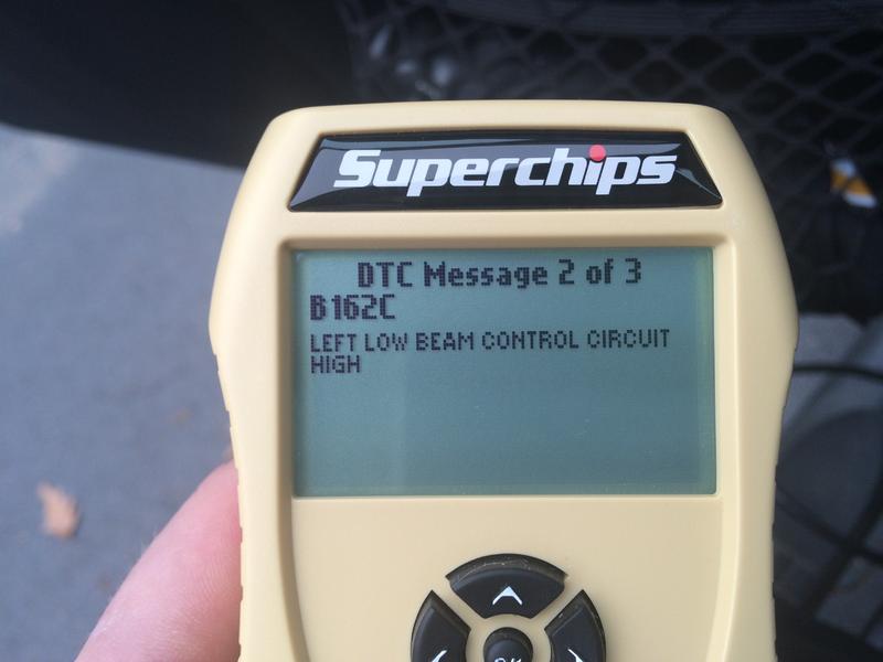

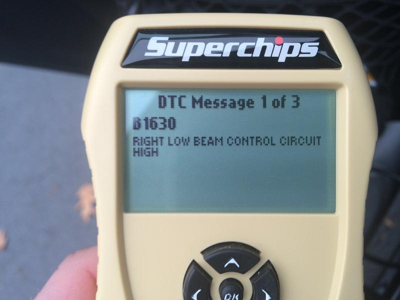

Recently I just realized that I never upgraded my gear ratio after I lifted my Jeep so I went and took care of it. I am running 35x12.50 tires and originally set it to 5.00 but after driving it today, the RPMs were pretty high, the check engine light was on, and it would get stuck in neutral when I had it in reverse. I drive an automatic 2014 4 door. I just reset the gear ratio to 4.56 (have not tried driving it around yet) and was wondering if that would help. On another note, I ran the diagnostics and got these 3 messages and was hoping to understand how to fix them. *I just installed a new pair of headlights that came with an HID kit*

I get those same codes now that I have an HID kit as well as some codes for my fogs since I swapped them for led bulbs.
