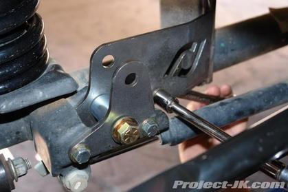

I read the instructions on the JKS front track bar brace and it requires that you have a SS that has a spherical bushing. In an effort to forgo this weird requirement by JKS, I was wondering if you folks with this brace feel that I can just leave the SS in the stock location? I wonder why they just did not bend the bracket enough to accomodate everyone running the factory stabilizer or teraflex, rought country, etc.

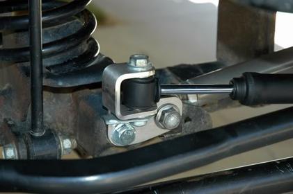

you can reuse the factory location. but you will have to rotate the ubolts to get it to work. less clearance this way
I ran mine like this till i got a woods relocation bracket

You have many choices here are a few more. There is nothing wrong with leaving the SS in the factory spot or you can also use the Woods bracket, it will work with either the JKS or the Currie. Remember this is part of the fun of having a jeep.
