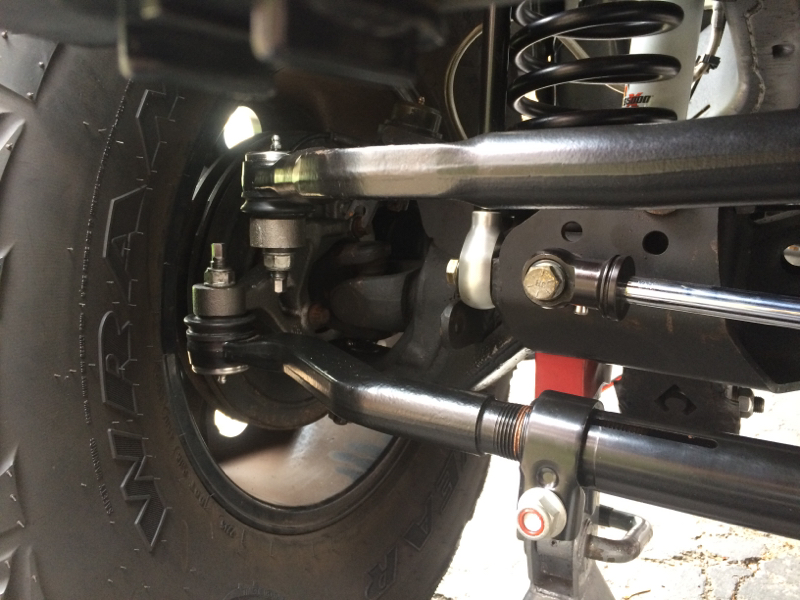

I want to put the JKS front track bar bracket on to raise ss mount but, not raise track bar till I get new Synergy drag link. Will I have hitting issues with just bracket or is it the track bar that gives the contact issues? I have 4" of lift and JKS adjustable track bar.

You might experience bump steer without flipping the drag link.
A little pricey but you dont have to drill or ream the knuckle to run this DL.
http://steersmarts.com/products/jk-w...mount-draglink
