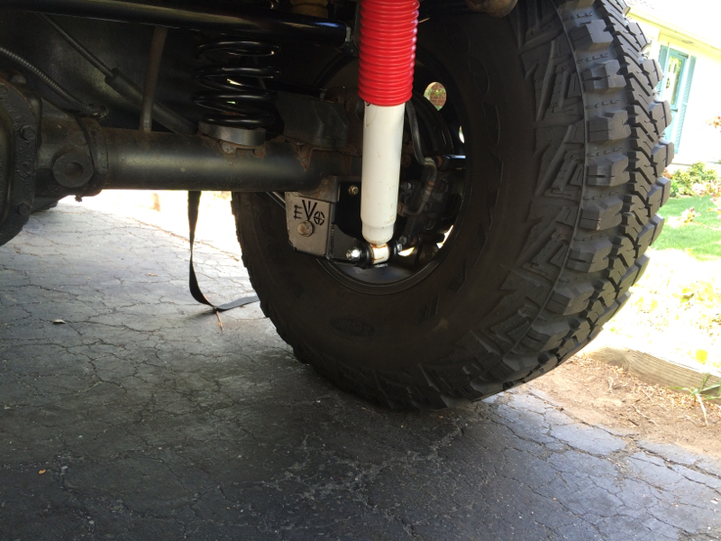

Evo rock Stars. Instead of increasing stop i chose a shorter shock. One benefit of a cheap $50 shock rancho 5000x's
I thought you wanted a longer extended shock since you're killing your uptravel with the mounts. With 3" bumstops or relocation mounts, you better be 4" higher than stock and have at least 28" extended shocks
