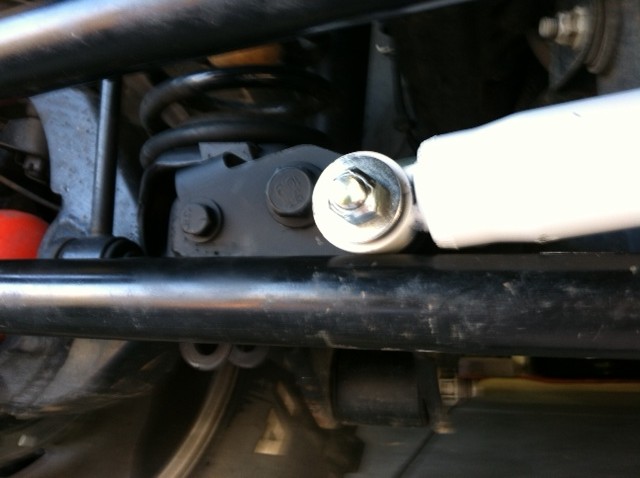

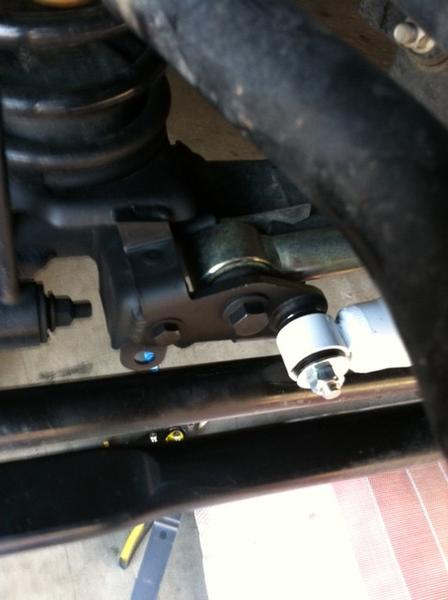

Welded on the JKS steering stabilizer bracket onto the trackbar bracket on the axle and my steering stabilizer rubs on the tie rod when fully turned right. Anyone else had this problem. It looks like the stud for the body end of the stabilizer is too close to the tie rod. Anyone had this problem and solved it?

Yep, mine does the same. They shoulda raised it another inch or so.

It rubs with my bilstein which is prolly the skinniest out there. Where it rubs, no stabilizer will work right. Engineering f'up on their part.
It'd most likely bind with a bigger dia tierod.

Yes, It'll rub the bushing mount.

I've never contacted them. I've been meaning to alter it and raise the mount bolt some way, haven't got around to it. I've posted this issue before though.

Just shot an email with photos to JKS to see what they say.
