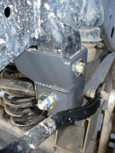

Default JKS trac bar brace
A couple months ago I picked up JKS trac bar brace "used" (never installed). I figured it would beef up the mount and just be good insurance. Now the question is, down the road will this have to be removed if I install a lift. I don't plan to go over 2.5 on the lift, if that. Right now, I have replaced the front coils (14s to 17s) and added a 1'' spacer and for the rear added 59s in place of 54s. So, I have a modest "lift" now.
Just trying to get the lowdown so I don't cause grief later on since this thing is to be welded on.

Old Jun 29, 2014 | 09:54 AM
Northridge4x4's Avatar
Sponsoring Vendor
Joined: Aug 2006
Posts: 5,892
Likes: 6
If you go with a lift kit that uses a bolt in rear trackbar bracket you will have to modify it to work

Old Dec 27, 2016 | 04:47 AM
lowendrider's Avatar
Posts: 1,205
Likes: 17
From: Oxford, AL
I thought I'd update this thread. I ended up going with a JKS 2.5" lift which came with an axle side trac bar bracket designed to work in conjunction with their brace. Very nice system, very stout. So the trac bar is raised and reinforced..should be bulletproof. Later I plan on adding the Synergy frame side brace...you guys know how it is, the mods are neverending Thats part of what makes Jeep ownership fun though!

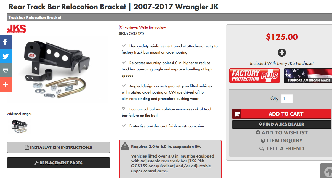

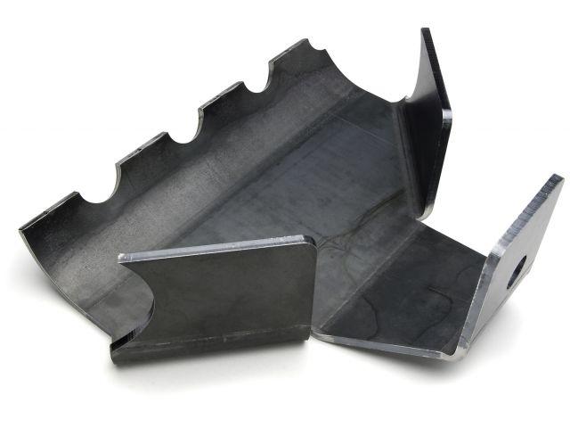

I'm about to pull the trigger and purchase this to beef up that rear bracket. Should you ever decide to beef up your rear drive shaft in the future (and have to rotate your axle up in the process), I think reinforcement of the axle and frame trackbar brackets should be high on the to-do list....
Name:	Screen Shot 2016-12-28 at 4.13.58 AM.png

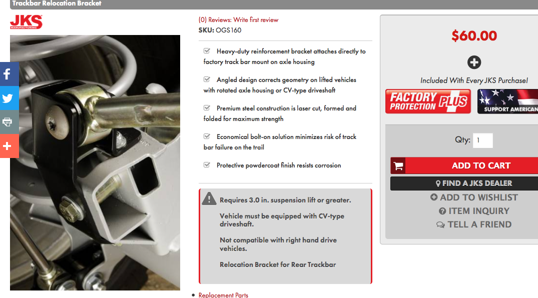

What I really need to find is someone that has made an angled and beefed up axle trackbar bracket. Here's the JKS angled version but unfortunately it's not really beefed up...
Name:	Screen Shot 2016-12-28 at 4.18.16 AM.png
...although it looks like this one might work....

Old Dec 28, 2016 | 07:23 AM
Bear9494's Avatar
Joined: Dec 2013
Posts: 28
From: Grants Pass, Oregon
I just made my own rear spring pads and axle side track bar mount to allow for rotating the axle pinion up.

Originally Posted by lowendrider
Your last pic is the bracket that came with my lift. I'm using it along with this brace which I had already installed.
So the bracket that came with your lift (Item #: OGS170), is it actually angled at the top like the smaller bracket on the 2nd pic (Item #: OGS160)?
It doesn't look like it from what I can tell on the JKS website and pics....
Shop By Product - Trackbar - Trackbar Mounts
