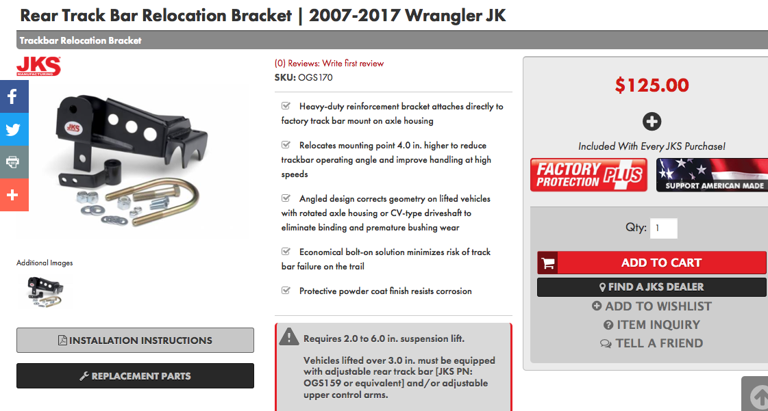

I'm about to pull the trigger and purchase this to beef up that rear bracket. Should you ever decide to beef up your rear drive shaft in the future (and have to rotate your axle up in the process), I think reinforcement of the axle and frame trackbar brackets should be high on the to-do list....
Attachment 663613

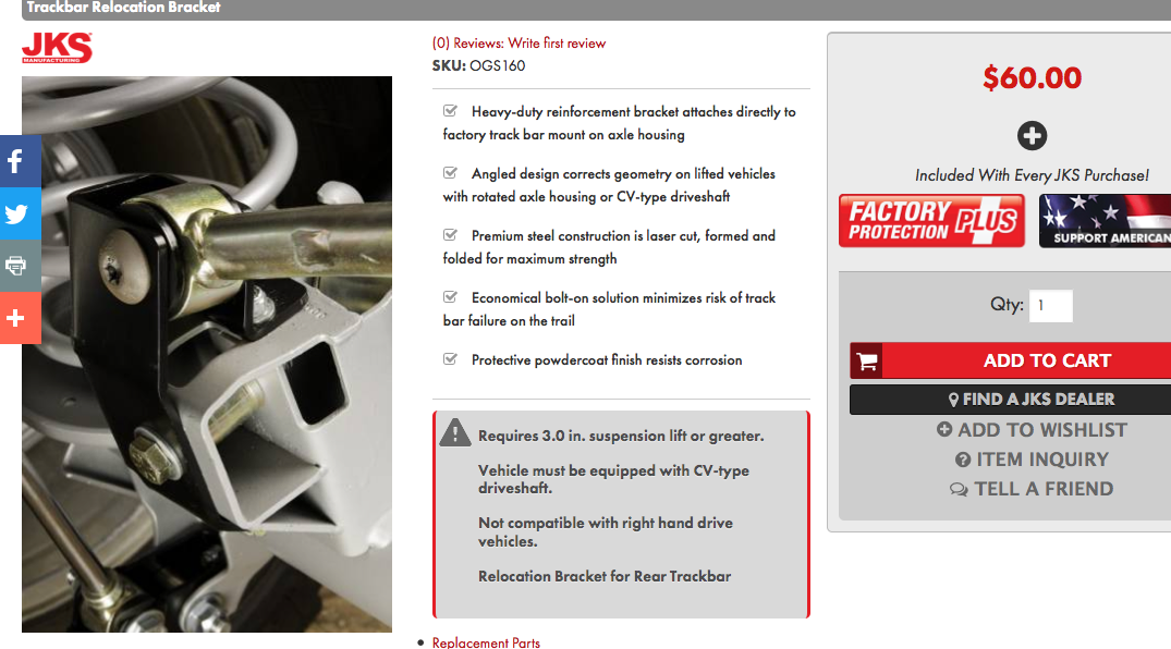

What I really need to find is someone that has made an angled and beefed up axle trackbar bracket. Here's the JKS angled version but unfortunately it's not really beefed up...
Attachment 663614

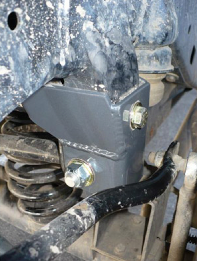

...although it looks like this one might work....
Attachment 663615
There are tons of track bar brackets out there. Ballistic, blue torch fab, genright, ruff stuff, barnes, brink, wfo, and artec all have heavy duty track bar brackets. Most of them also have multiple mounting points so you can fine tune you height to your lift. Cut that old weak junk factory bracket off and install a HD model. Don't forget to rotate it back a bit if you have a lift so things line up right.

Originally Posted by DJ1
So the bracket that came with your lift (Item #: OGS170), is it actually angled at the top like the smaller bracket on the 2nd pic (Item #: OGS160)?
It doesn't look like it from what I can tell on the JKS website and pics....
Shop By Product - Trackbar - Trackbar Mounts
No angle. The bracket that came with my JKS only raises the mounting point. Being that the two parts are from the same company, they happen to work together nicely...which was good in my case since I already had the brace welded on.
