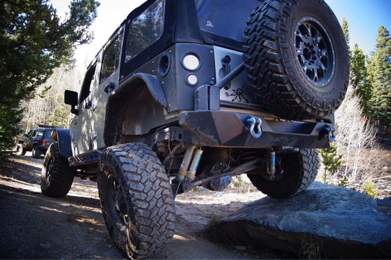

Here is a pic of how I have the RK track bar.
