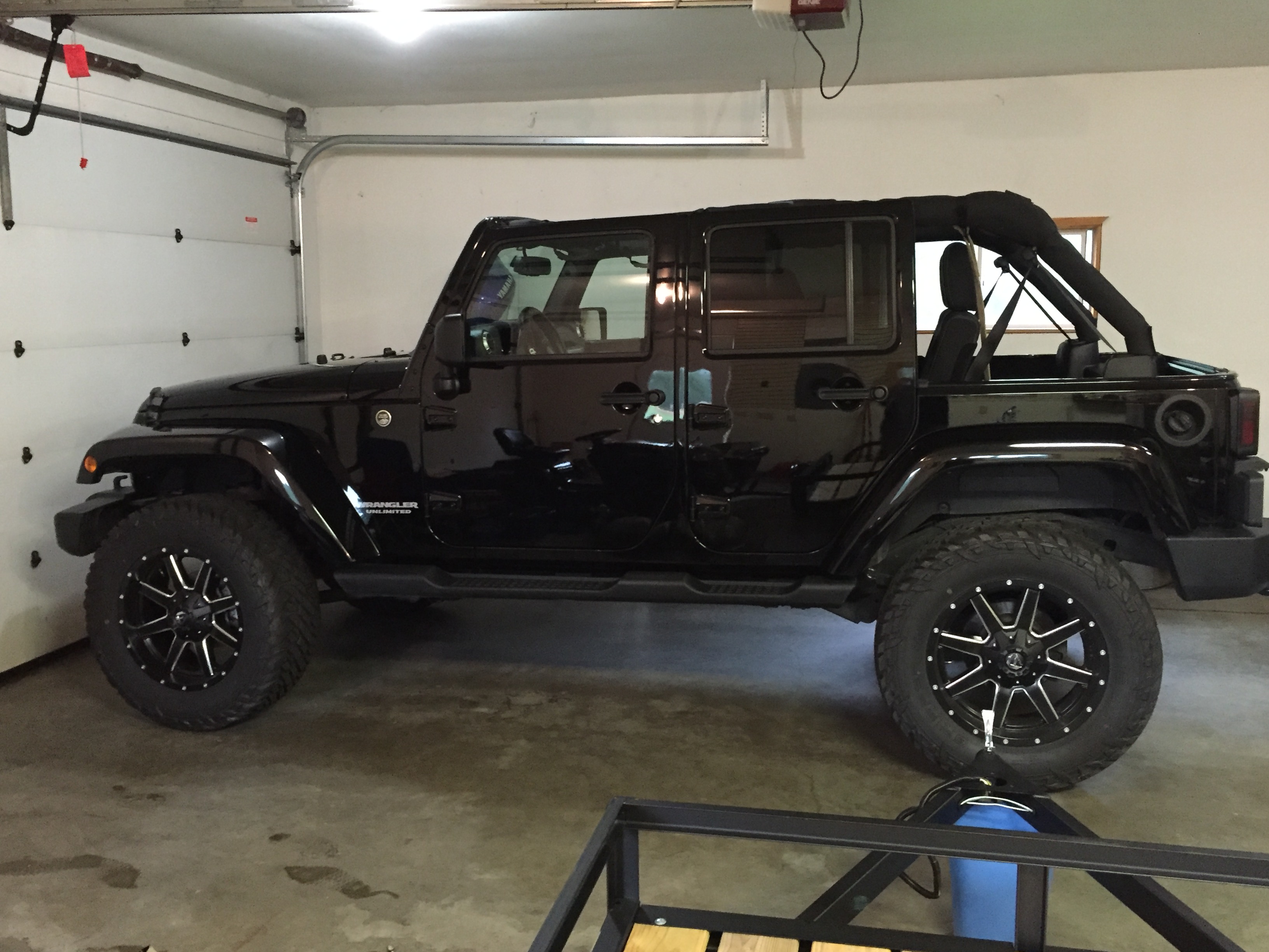

I recently purchased a 2013 JKU Sahara with a 3.5" Rock Krawler mid flex installed, I would like it so sit level. Is it adviced to add a .75" -1" leveling kit in addition to the lift? Or so there a better way to level it out?

Do you plan to add any additional weight to the jeep (bumpers, winch, sliders, etc), or is it going to stay in its current form for a decent while? If you have any plans for change, I'd wait till after those, otherwise just level it out if it bothers you that much.

Front? If so just wait. The rear coils are rather soft and will settle.

Yes the front sits lower, I do not plan on adding much more weight... The lift was installed about 4k miles ago, how long does it settle for?

Yeah to be honest mine are still sitting higher than the front after 5k miles and a few wheeling trips. 200ish pounds of stuff in the trunk, back seat in, Genright carrier (19 lbs), and CC rear bumper (no additional weight since the crossmember was cut off). Front has a CC bumper too, so no real added weight there, and a PowerPlant (maybe 80 lbs?). It's noticeably lower in the front. Doesn't bother me since it sits level when I accelerate. Might toss a .5" spacer once it warms up.
The front definitely settled a little, but back is still just as high as it was before. This is also why I haven't installed new rear coil perches...I don't want to sit any higher in the rear.

plans to throw a tire carrier on the rear? That would make a big difference. Looks like you have the nice streamlined look at the moment.
<img src="https://www.jk-forum.com/forums/attachment.php?attachmentid=666209"/>
Kind of looks like you have that street rod look going on.
Throw some smaller tires in the rear and that oughta level right out.
