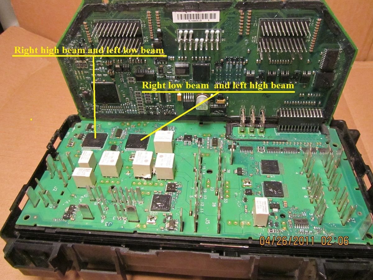

Here's a picture of the drivers that control the headlights. Since both headlights behave the same, the problem must be with whatever tells them what to do.
The dealer can hook up to the Jeep and monitor computer commands and responses; might be expensive to have them do it. Can your JScan do that?

In the meantime I'm going to bypass the tipm till I sort out some $ for a check by a dealer or someone similar.
