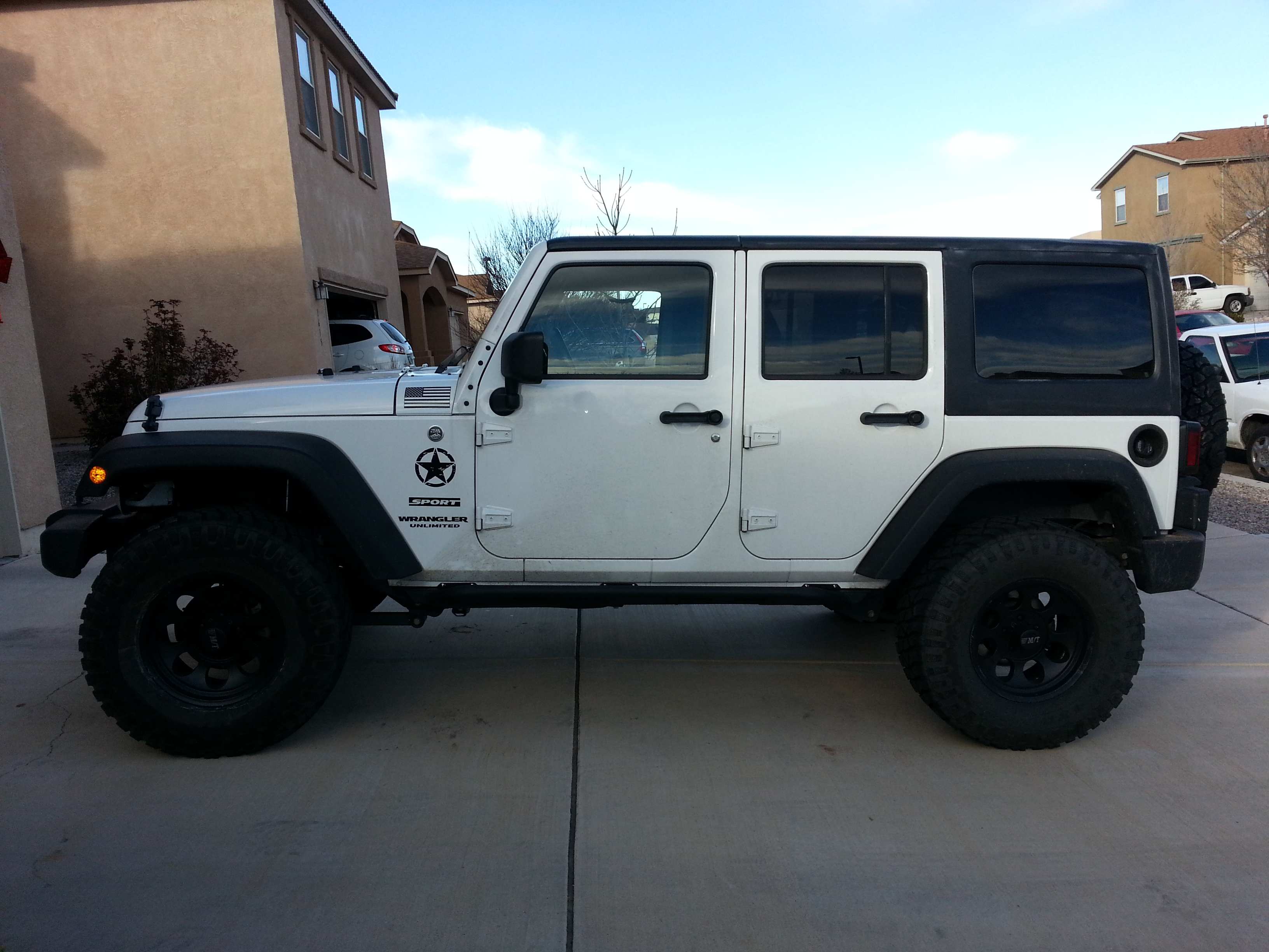

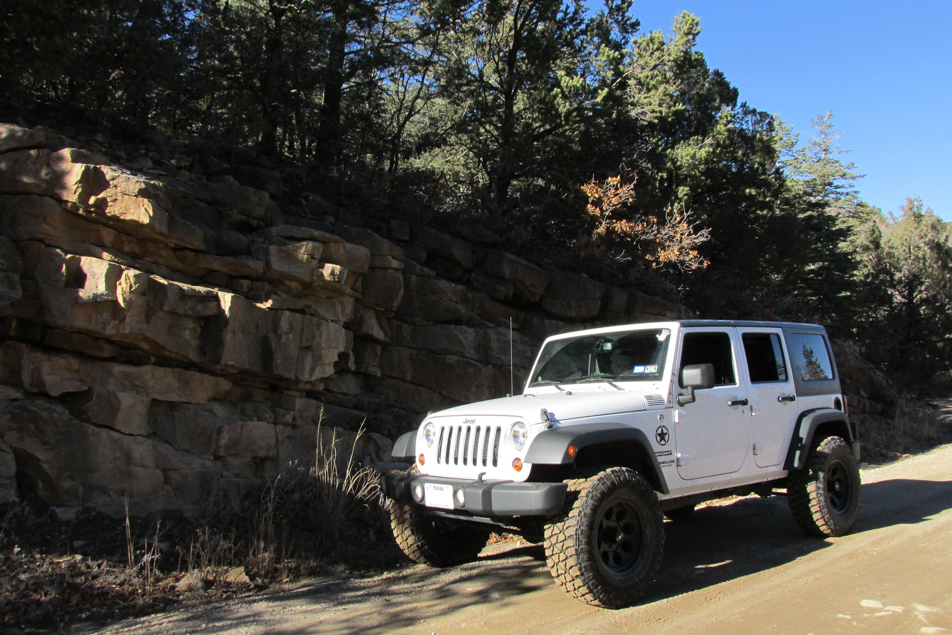

Here's my Jeep, 2013 JKU Sport. 2.5" Teraflex coil lift with shocks, running 315/70r17's Kelly Safari TSR's on Mickey Thompson Classic III's. I currently have 3.21 gearing, but am planning to change that at some point, probably to 4:10. I am not running a tire carrier yet, I will when I upgrade my rear bumpers to JCR Offroad. As of right now, that spare tire actually sits on the bumper perfectly. If you are just looking for aesthetics, I would probably go with the Teraflex budget boost. You might also want to consider a new trackbar to recenter your front axle as it will slightly shift to one side after the lift. I have the Monster Track bar from Teraflex as well.

To clear the 35s for DD and light/moderate off roading, will a 2" BB be sufficient? DO I need the 2" in the rear or will the 1" in the leveling kit clear? Looking at Vals rig (which is bad@ss and almost exactly what I want aesthetically) , there doesn't seem to be a lot of room between the flares and the tire. Would I need to also trim the flares? Will it not rub in light wheeling situations?
