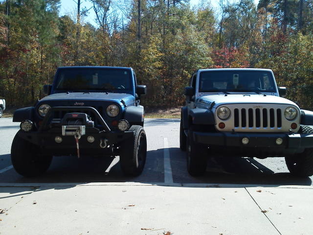

18/59 springs, shocks, Rubi 255/75/17 BFG tires and 17" wheels with spacers.
Next to stock sport with the same options on right before mods.

Highly recommend, but I do regret not adding the spacers like you are thinking about. I'm going to install a Teraflex leveling kit down the road.
