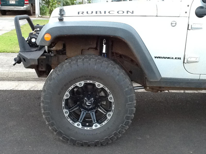

Well finally complete. Took some photos quick before the sun completely went down. Rides like a whole different jeep. Had to put some dirt on it as you can probably tell. worth every penny so far!!! Last picture was before....
