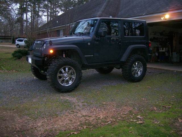

I am pretty sure you can clear 37s if you chop the flenders and the pinch seam. I think the factory front bumper can get in the way too. Not sure on that, or what bumper you have though.
When I first put on my Tera 3" I got like 5" front and 4" rear. It has settled a tiny bit, but I still got over 4" out of it. It clears my 35s by a long ways. I think Teraflex says that the 3" rating is for a four door with a hardtop and aftermarket bumpers or something. I know I saw in the tera catalog that it said something about 2 door soft tops getting up to 5" lift.
