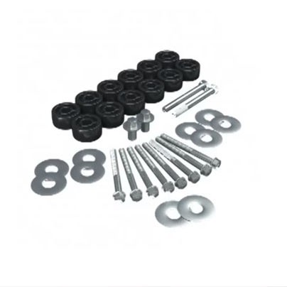

heres what you get

forgot about updating this
the install was a breeze
followed the provided instructions
the only thing that was lacking from them was torque specs for the body bolts, but that was easy to find on me own
the extra 1.25" was well worth it
after purchasing then selling after not installing rough countrys body lift i can def say that teraflexes kit runs circles around rc's
with the teraflex use dont have to try to reuse any of your old hardware
they give you all new stuff
so no banging bolts out of body mounts or grinding washers down
it took us about an hour or so in a dark driveway
the extra 1.25" helped me get that little bit of extra tire room for upward travel that i needed/wanted
plus it took my 2.5" suspension lift and made it look like a 3.75" lift without raising my center of gravity any more or increasing and steering or drive line angles any more.
people who say body lifts are crap are wrong (unless theyre talking about a pos kit and/or one that is like 6" tall)
1.25" does not leave a noticeable body gap AT ALL
most of the guys in my club didnt even know i had installed a body lift, they thought i took off my 2.5 and added a 4".
i give the lift kit by teraflex a 9.5 out of 10
would've been a 10 if the price was a little less, but i understand they have their name on it and it was done right.
thanks teraflex!
