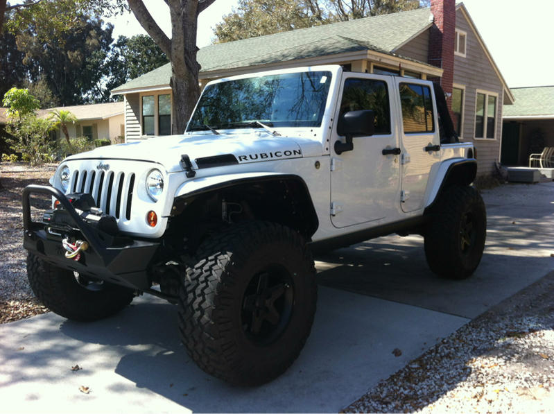

Zeon
It may or may not work with the PSC bumpers. I have seen a few that did fit on the Brawler Lite but they were extremely close. Mine would not fit. The ends of the winch contacted the bumper on each side leaving a small gap at the mounting points. PSC just released a spacer plate to address this potential issue. It is very close, you may need it and you may not. Good luck.
