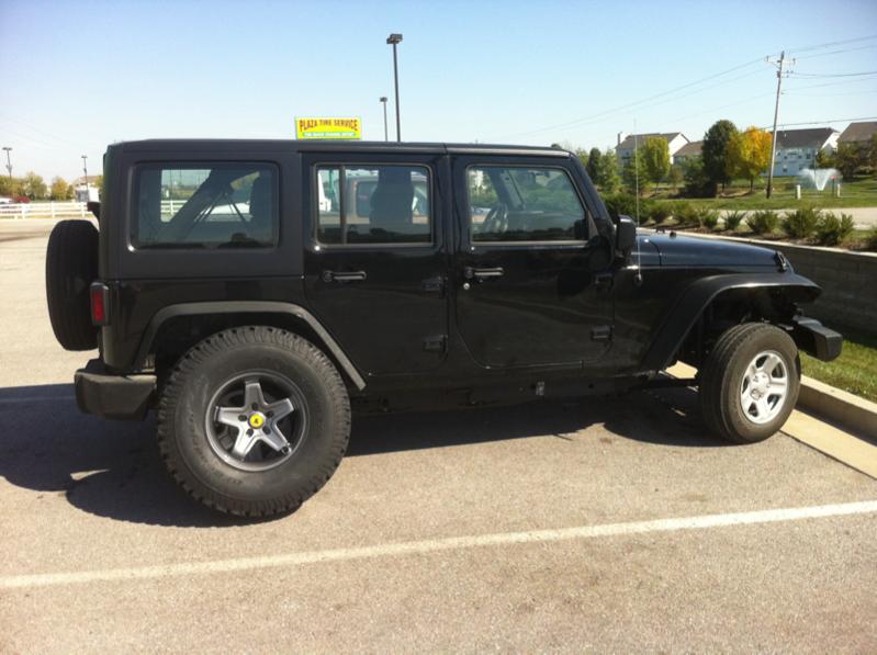

Should be enough with pinch seam trimmed. In this pic my fenders are trimmed, 1"body lift with 37" leaning up against the jeep.
OME lift going on this weekend and chopping the front bumper.

This is what it looks like with the 35s
Although I dont think it looks to bad as it is, Im just checking for "future reference" of course
bumpers and winch come in friday so it will come down a bit

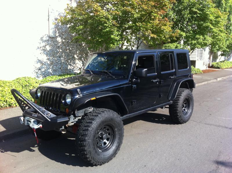

I put 37's on my JK with a Full Traction 3'' lift......
If you plan on adding bumpers/winch definitely look at getting 1'' front and rear spacers and also readjusting your bumpstops. Otherwise if you have people in your back seat plus some stuff in the trunk you will get a lot of rubbing.
