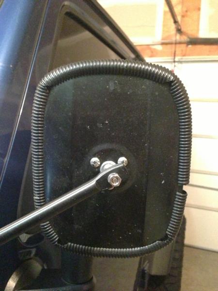

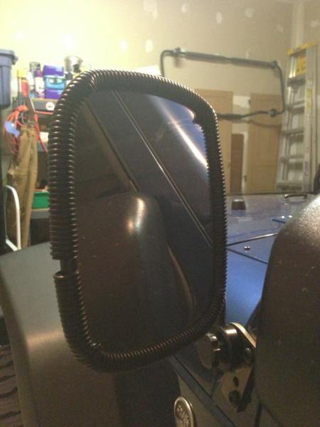

I used the plastic tubing that's used for electrical wires under the dash, just cut a slit around the corners so it would stay on. No more whistling......

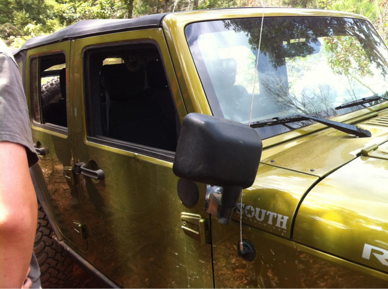

Yeah I loved mine too, until they met a tragic death.
