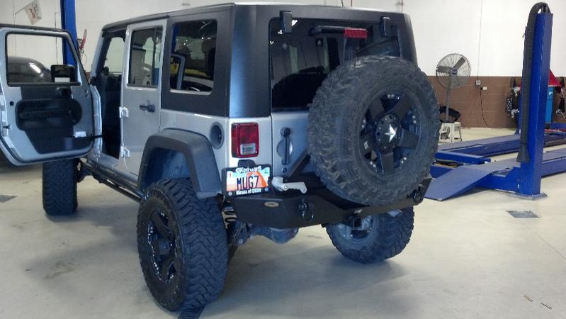

My stock carrier broke with my 35's around 25,000 but then again i am really rough on things i think you should be fine running 33 i would just make sure that they are torqued that was what did mine in. Xrc
