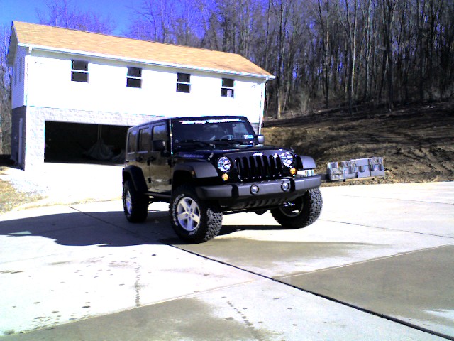

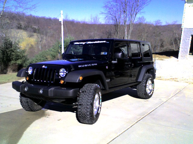

07RubiJK's Avatar
Joined: Jan 2007
Posts: 66
From: PA
camera phone pics, but you get the idea.

Old Mar 12, 2007 | 12:22 PM
duffman's Avatar
Joined: Nov 2006
Posts: 91
From: Fresno, CA
Looking good 07RubiJK! My tires arrived this a.m. Just waiting for the teraflex bb which should be here wednesday for a weekend install.
