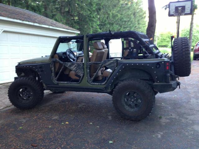

This is the RK 2.5" max travel with 35's. Insanely effective.

Agreed. I'm running the same lift, minus the control arms. Works quite well with my 37's.
