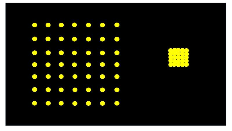

There's a lot of myth and misconceptions about lights in general and headlights in particular.
The JW have a large hotspot at the center. This makes the impression of an overall brighter light, but that's not the optimal light pattern.
What we need is a light pattern that's as even as can be, and wide enough to shed light on the road sides as well.
The new JW still have the large hotspot at the center.
The TruckLite have a more even and quite wider light spread.
This is how and why a hotspot in the center misleads our perception and makes us think that one light is overall brighter than the other:
Name:	How NOT to evaluate or picture lights.jpg
The light on the right looks brighter. It consists of 25 similar "bulbs".
The light on the left looks dimmer. In fact, it emits more light... it consists of 49 bulbs.
The one on the left sheds almost double the light on the road ahead than the one the right.
The same perception error happens when comparing JW with TL.
(The same also goes for taking pictures in front of the lights, instead of from the driver seat - which show the actual lighting result rather than the reflector glare.)

Great info to have

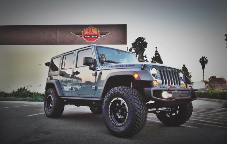

I have TruckLite headlights with the optional pulse with modulators to correct even the most minute flicker and JW speaker fog lights installed on my 10A I love it. Have had them all installed a little over a year now and have no complaints or issues at all. The combo makes for a unique look too if I don't say so myself.

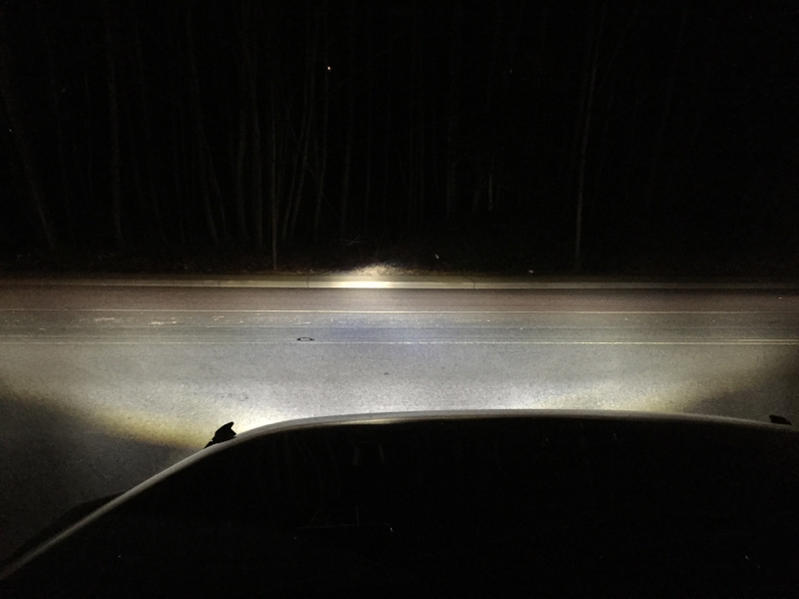

As far as a bright spot. I'm assuming you mean the point wear they over lap at the tip?
This is a pic i just took of the 8700 evo 2s, low beam pattern. I'm pulling out of work parking lot so my front wheels are 8"-12" lower than my rear wheels. I'm shining my lights onto a 5 lane wide road (2 lanes each direction and 1 center turn lane/median). Seems pretty uniform to me expect for the very top center where the lights over lap. Also love how bright the edges are; they are a wider pattern than my fogs throw.
