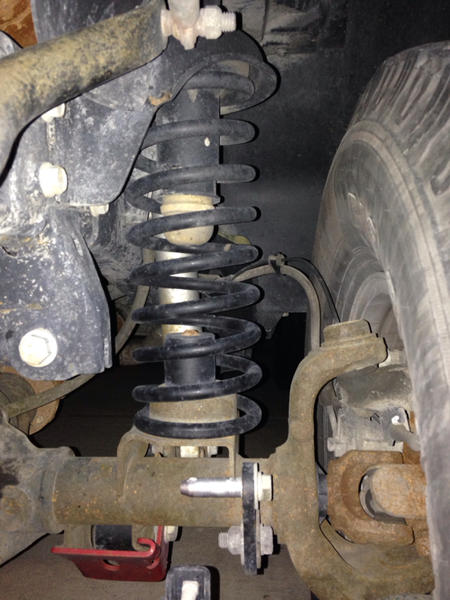

Old Mar 7, 2015 | 06:35 PM
7kings's Avatar
Joined: Oct 2013
Posts: 577
From: North Port, FL
Originally Posted by JKNRND
I *think* I can see isolators at the top, but it's tough to tell from the pictures. You should be able to tell pretty easily by looking at them. Also, I notice that one of the pictures is showing a 2.5" skyjacker coil - is the other side the same?
Old Mar 7, 2015 | 06:36 PM
JKNRND's Avatar
Joined: Jan 2015
Posts: 39
From: South Padre Island, TX
I think we submitted pics at the same time. I will check one more time. I park outside, so hard it's hard to see. I'll give it one more go tonight. Only thing I can see from the photos, is that it looks crooked. I tried to take the photos at the same angle...
