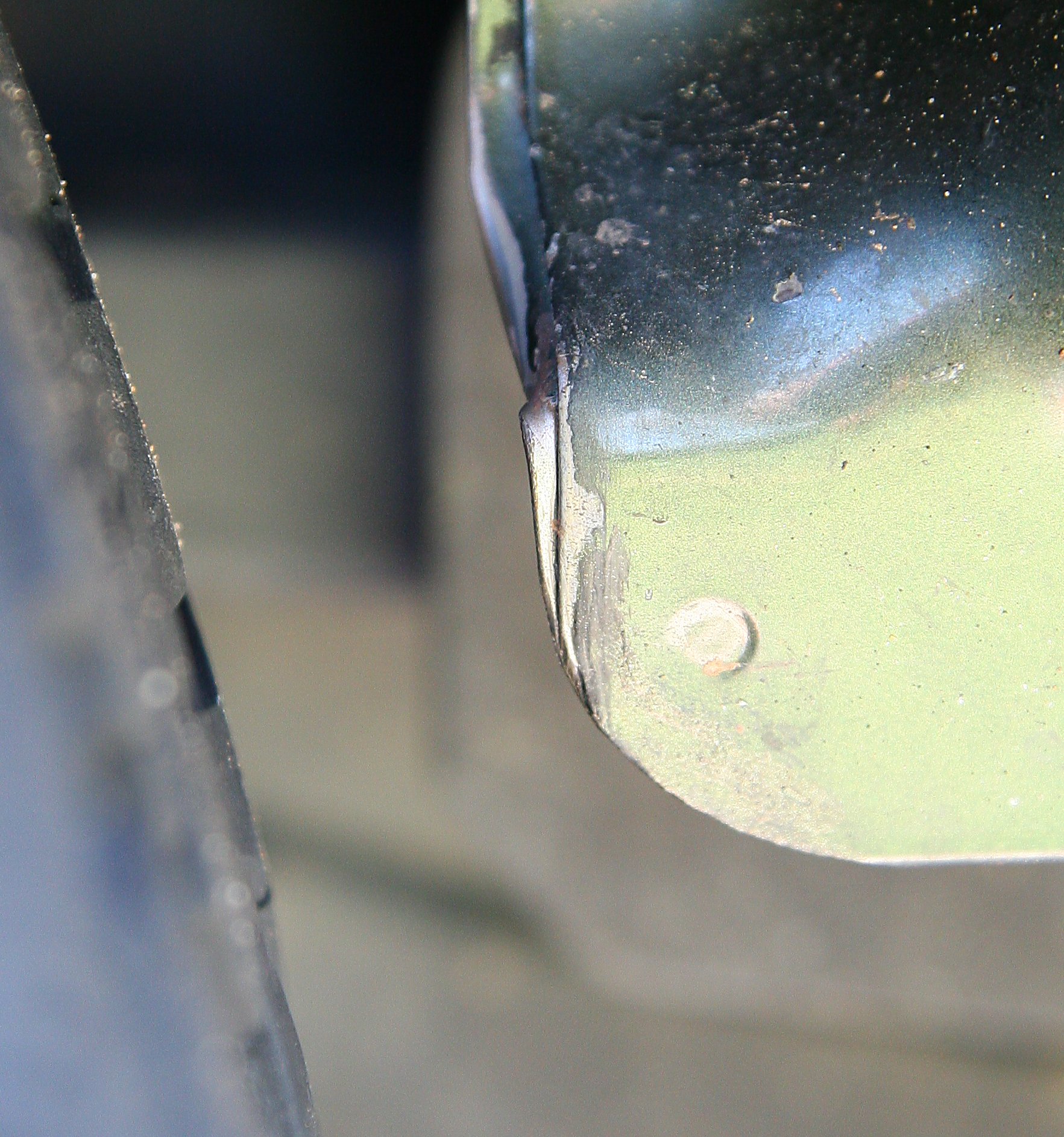

I used a body saw with a fine tooth blade, it tears less on the paint. I'll go take a picture for you but I do intend to take a little more off to round out the wheel well. I'll also be trimming the rear because it has a corner that sticks out. That corner will catch a a slightly stretched wheelbase with 37's.
The seam and rails have been cut back for 35's.

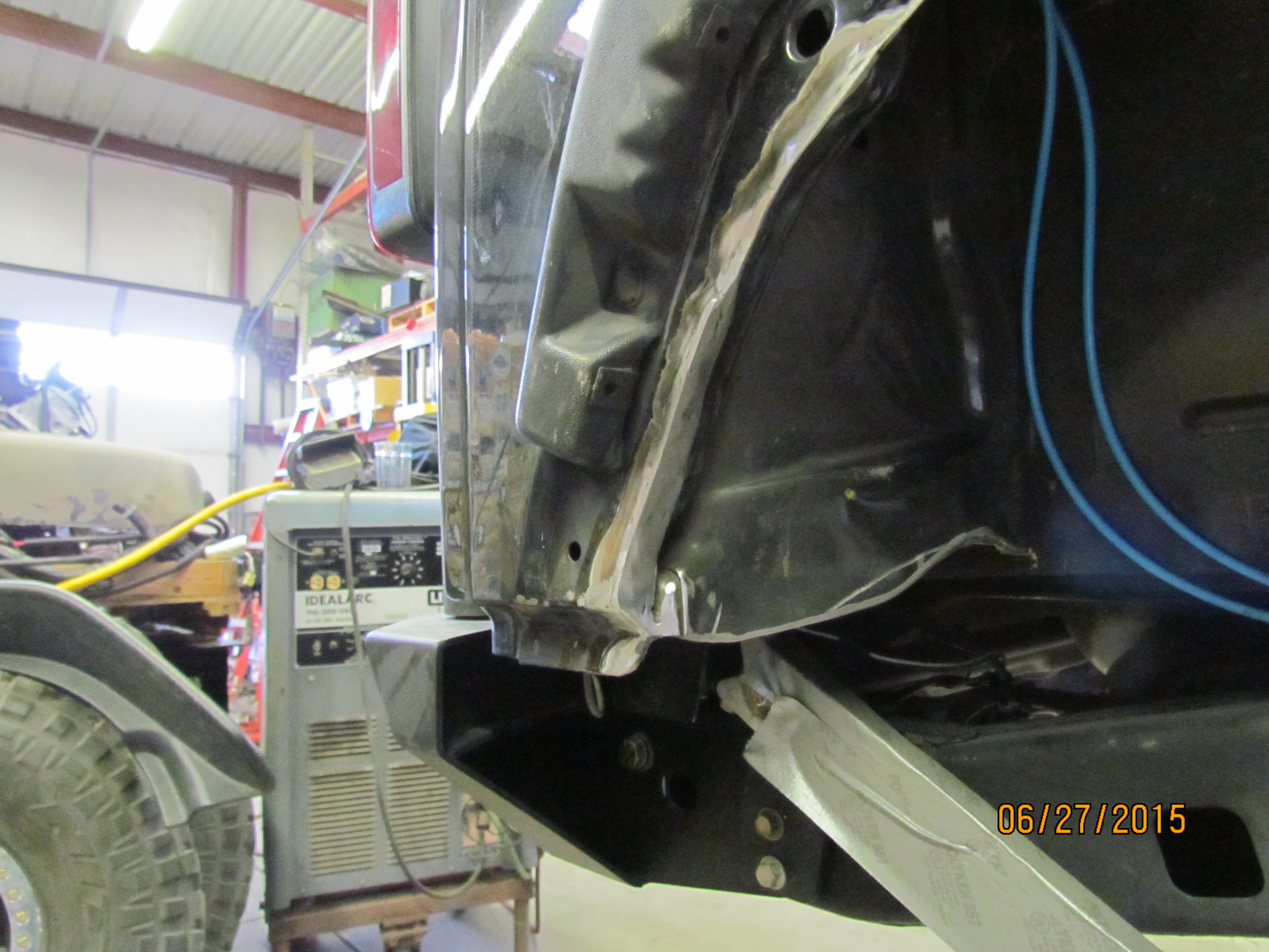

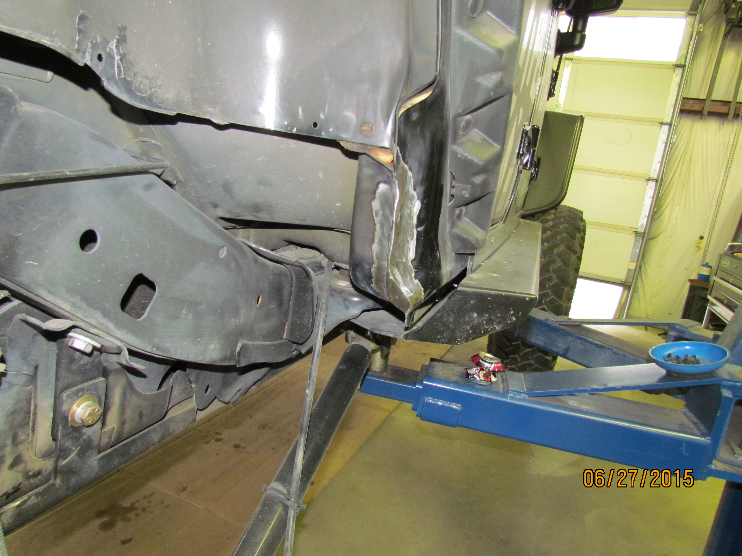

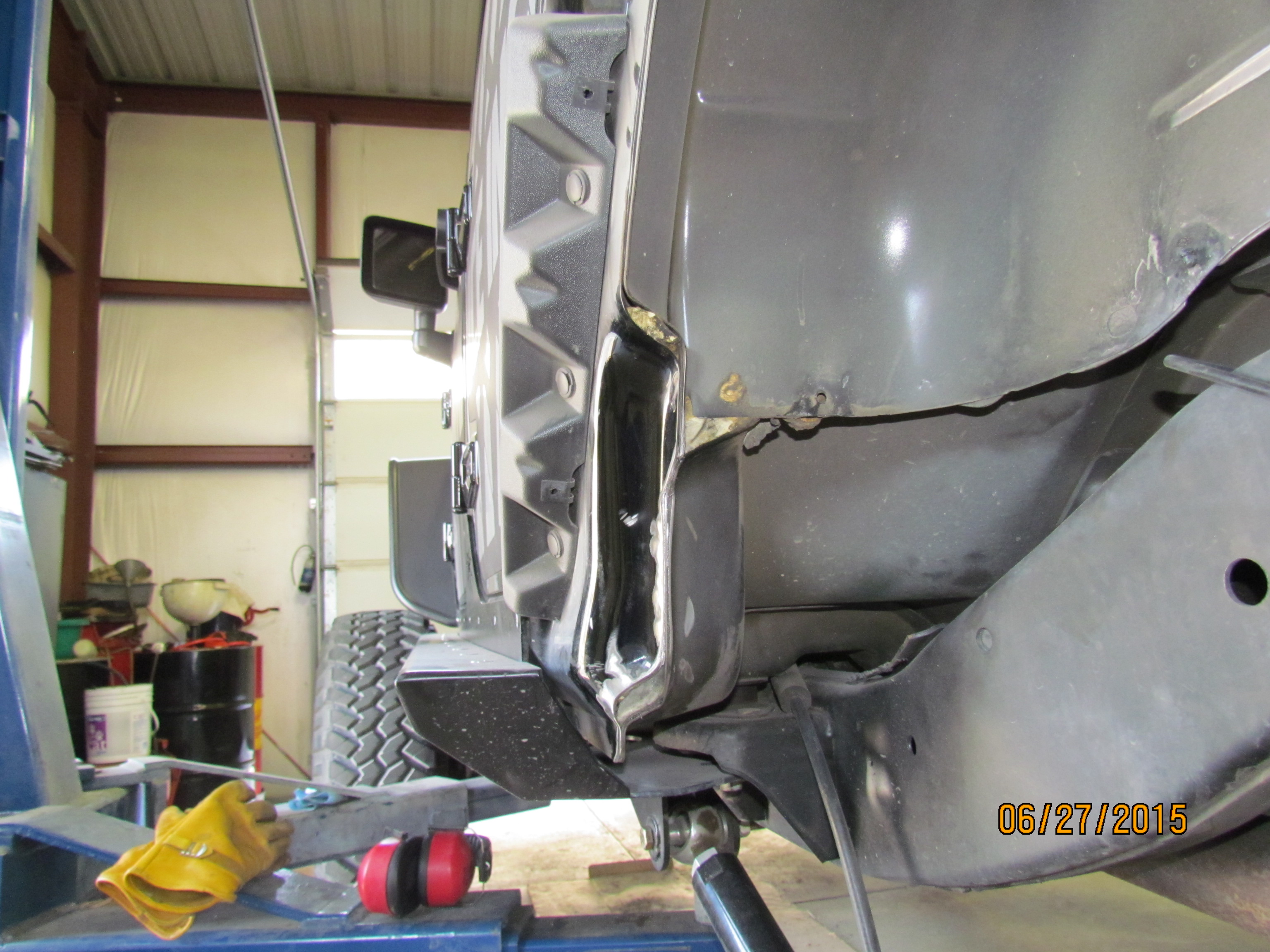

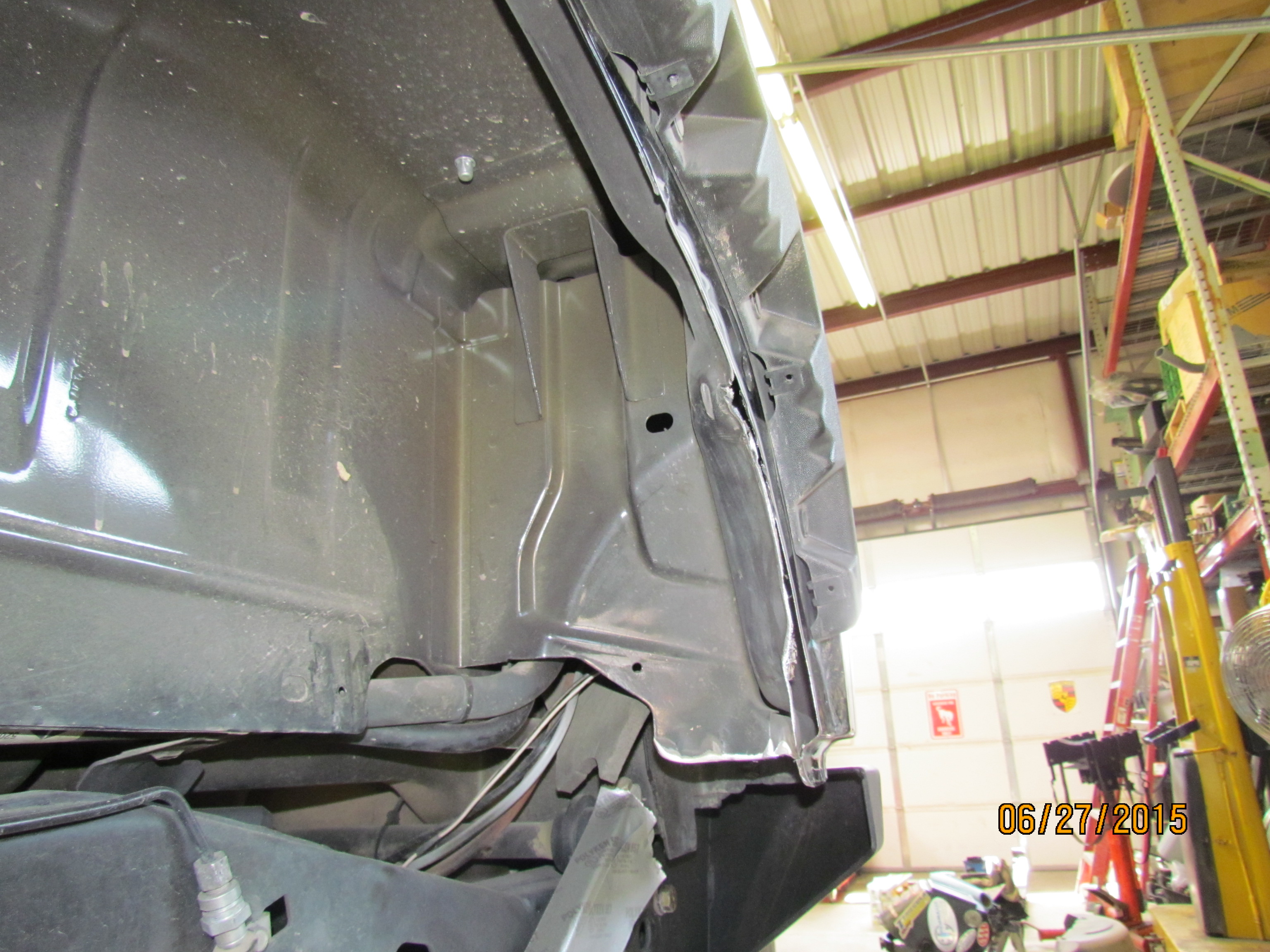

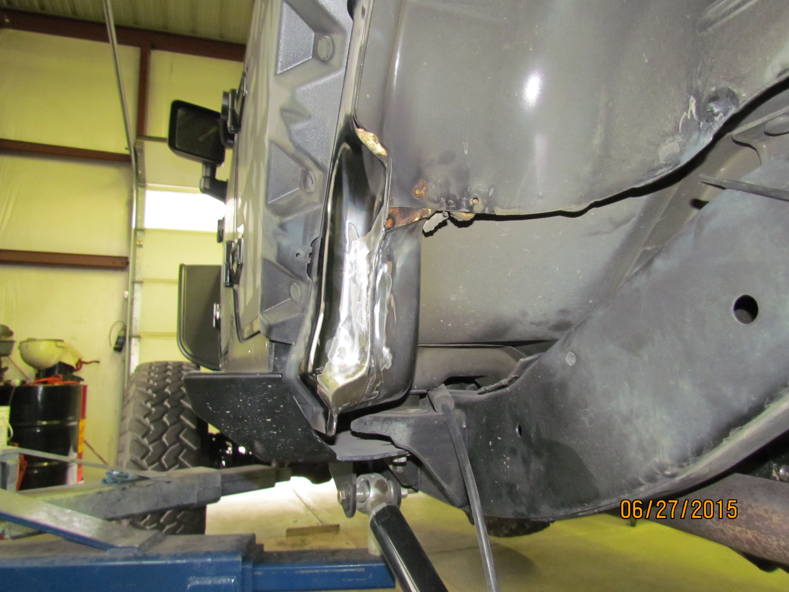

Cut it out and make a sheetmetal plate and Tig it in
ID:	673075   Click image for larger version
ID:	673076   Click image for larger version
ID:	673077   Click image for larger version
ID:	673078   Click image for larger version
Old Jul 8, 2017 | 07:20 AM
prelucir's Avatar
Veteran: Navy
Posts: 508
From: Denver, CO
That looks great. Unfortunately, i do not have a tig or the skills. I will see if the shop can do it.
Old Jul 9, 2017 | 03:49 AM
BoraBora's Avatar
Joined: Mar 2015
Posts: 712
Likes: 67
From: McLean, VA
You reallllyyy don't need to man. That's definitely a cool way to do it, but also unnecessary. He just went the extra mile since he can Tig weld. People have been doing it the other way (chop and paint) for years. It works, do it.
