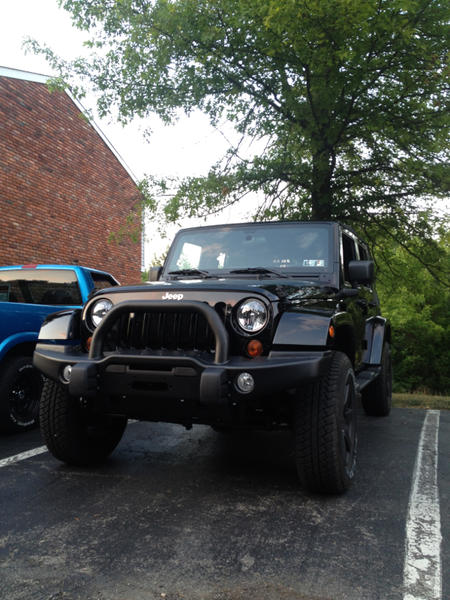

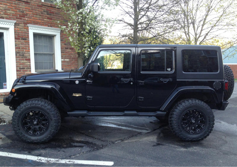

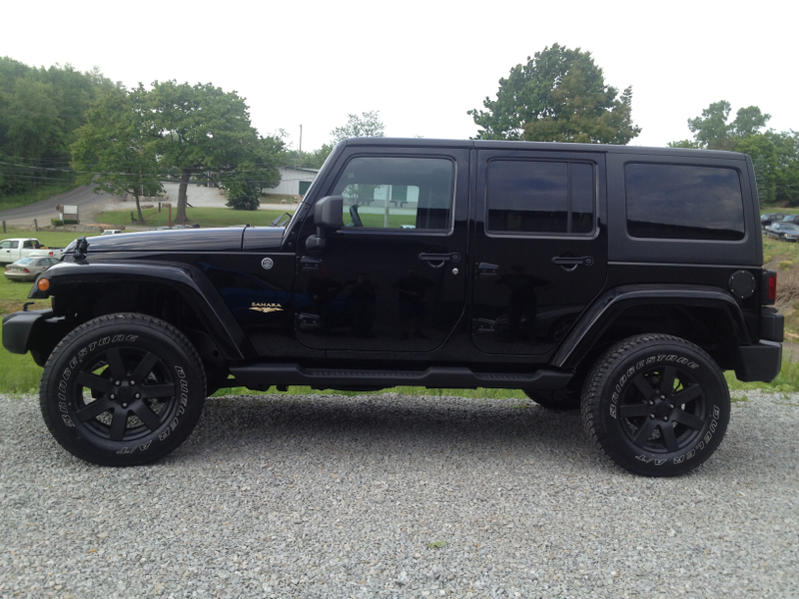

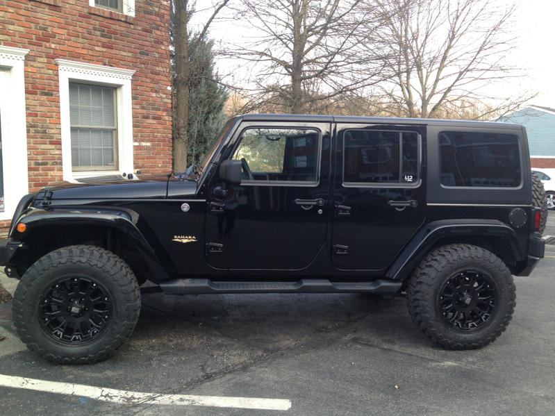

TF 1.5" Leveling Kit:
TF 1.5" Leveling Kit w/powder coated wheels:
Side angle of TF 1.5" Leveling Kit plus Spidertrax 1.5" Wheel Spacers:
TF 1.5" Leveling Kit with Toyo Open Country M/T's 275/70R18 (33"x11")
TF 2.5" Budget Boost with Mopar 19/60 Spring Upgrade and Toyo OC M/T 275/70R18

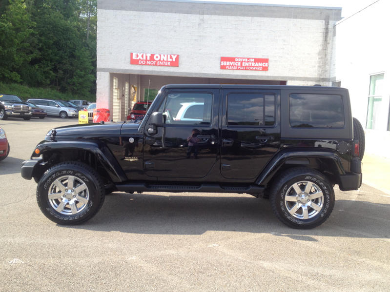

Thank you!!!! That's pretty much what I want my black sahara to look like, however it was my wife's for the last several years (we just traded my car in and she got the new car) and she had to have the chrome edition package and premium chrome package on the jeep...not sure if I am going to remove the chrome or not yet...but here it is in stock form:
You HAVE to run spacers with 33"s on stock Sahara wheels or you will rub the front sway bar. IMO the chrome is horrible but to each their own...
I agree...my wife wanted it, or no Jeep. It was her daily driver for the last few years since we bought it, so she got what she wanted. At least I got a Jeep into the family. For what it cost us when purchased, I can't come to take it off...maybe I'll plastidip all the chrome parts????
