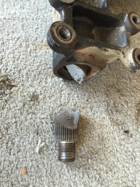

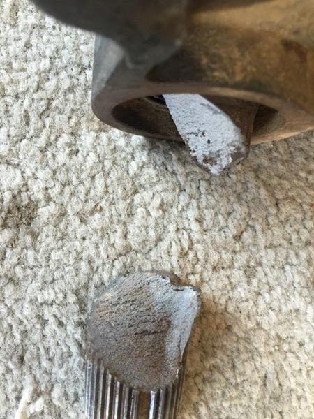

Default Heres what happens with no Brace
Running 37's hit a boulder coming off an obstacle that I did not see.
Finding a steering box on Saturday afternoon = NOT FUN.

Originally Posted by PhxSilver
Running 37's hit a boulder coming off an obstacle that I did not see. Finding a steering box on Saturday afternoon = NOT FUN. <img src="https://www.jk-forum.com/forums/attachment.php?attachmentid=586333"/> <img src="https://www.jk-forum.com/forums/attachment.php?attachmentid=586334"/>
Super glue.
