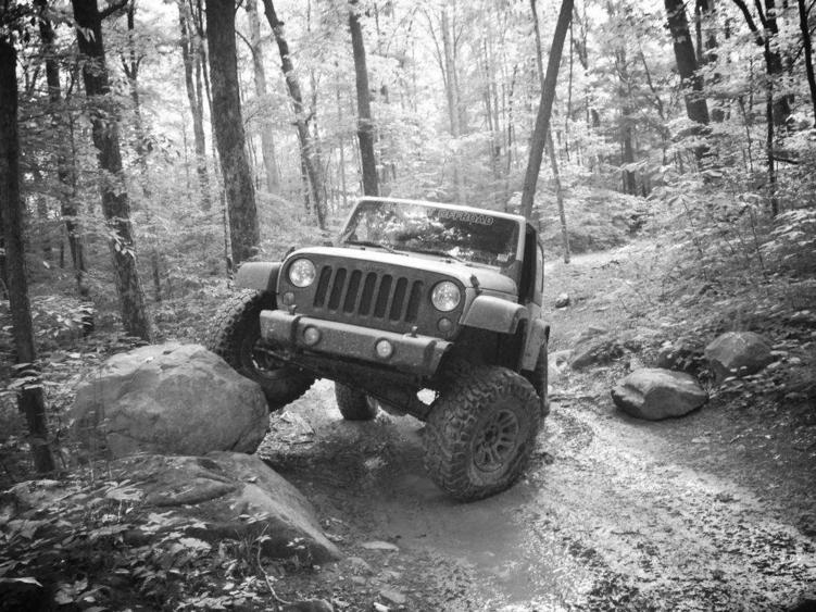

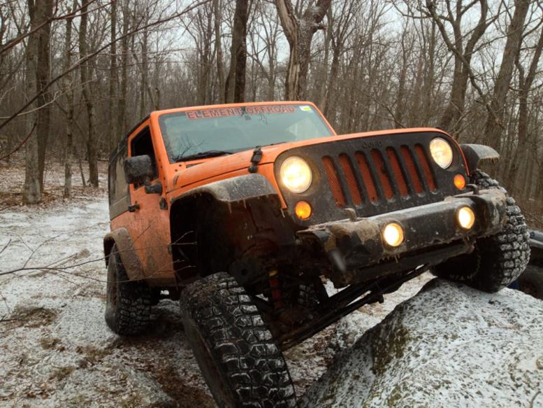

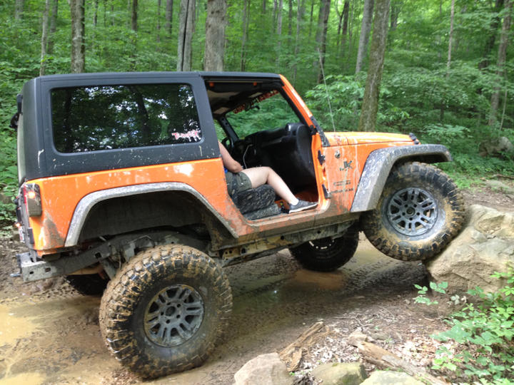

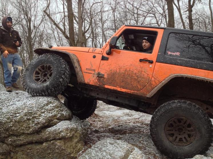

If you're not disco'ing, you could easily run 35's on just the leveling kit and cut pinch seam. Cutting fenders would help significantly as well. Here's some pics of my 2.5" bb and disco'd flexing. You'll be fine. I have zero rub even when i had full fenders. I'd skip the body lift. Does nothing for you offroad. You can run 35's stock height on the street.
