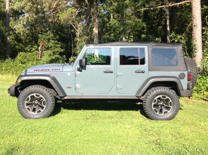

jeep-addiction's Avatar
Posts: 267
From: Locust Grove, Arkansas
Got it done today thanks for the help!!
Teraflex leveling kit spacers not springs, 295/70/17 toyo open country mts with spider trax 1.5" wheel spacers. Winch gets installed next week!!

Looking good

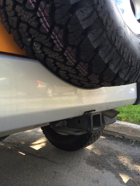

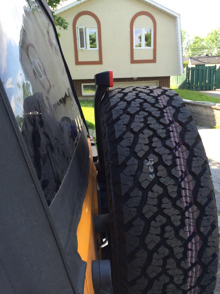

jbaubry's Avatar
Posts: 119
From: Montreal
275/70R18 on stock spare holder. Fits but tight.
