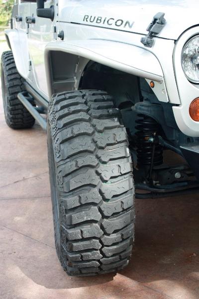

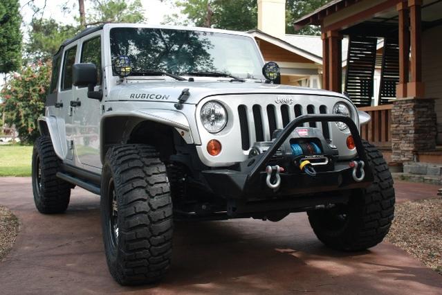

Teraflex Performance leveling kit< poison spyder crusher flares and 35s.
ID:	208214Click image for larger version
